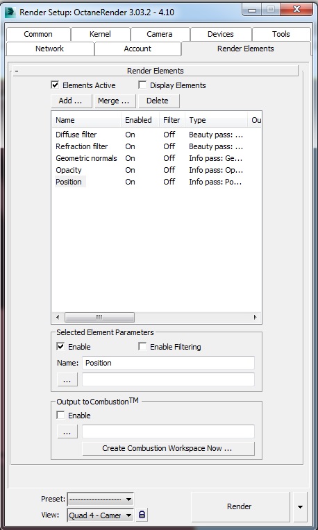

Use this passes:Leonides02 wrote:How come nobody has gotten a straight answer on which passes to use?
beauty - beauty
normals - geo.norm
position - position
albedo - diffuse filter
visibility - opacity
caustics - refraction filter

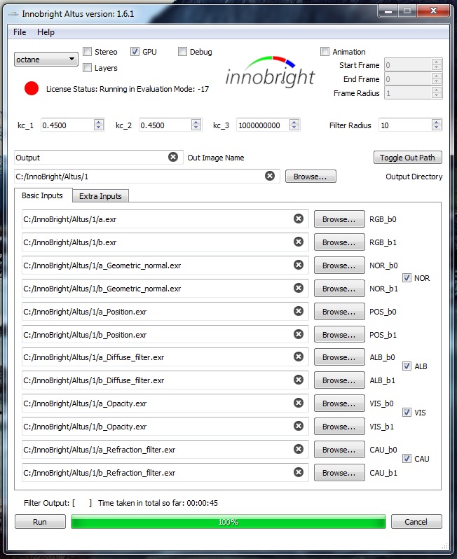

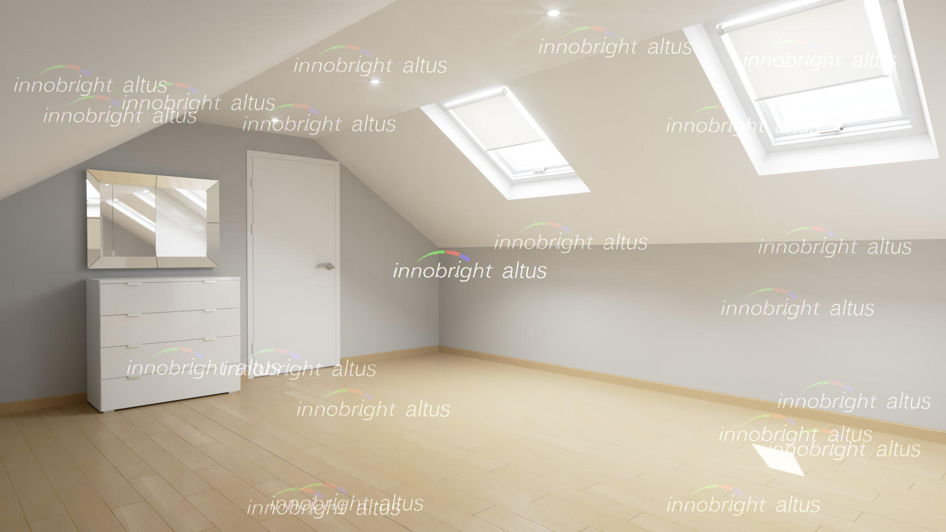

I don`t know why you have problems with Altus from my test
you can see I used following passes:
Render two different images with same max samples in this test I set max samples to 1000, turn off static noise also set coherent ratio to 0 save image to exr.
Keep in mind Altus uses GPU memory for processing, quote from their site:
"Can I process 4k images with the Altus?
Yes 4k image filtering is possible with Altus. However, there is a significant increase in the memory usage/requirement. Since all the images are uncompresed in memory, you will need at least 16GB of RAM available at the time of filtering for a single image assuming you are using every input. Currently this is possible on CPU and is not currently possible on a single GPU. It is theoretically possible on GPU using a high end SLI solution such as a Tesla cluster."
AMD FX 6300, 24 GB RAM, Gigabyte ga-990fxa-ud5, 2x MSI GTX 780 3GB

Ok, so it works for me only if I don't include the OPACITY.EXR
The required three (beauty, normals, position) works and so does albedo and caustics.
Opacity gives me a black image.
Can anyone else confirm?
