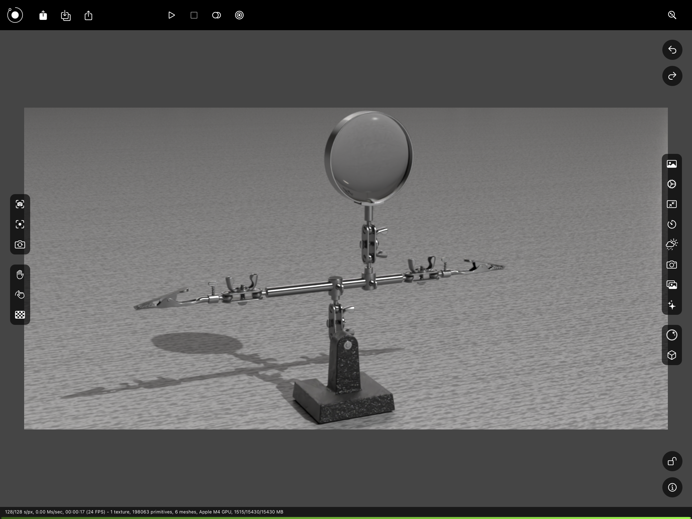

I love to work on iPad Pro for 3D works, especially with new M4 version!

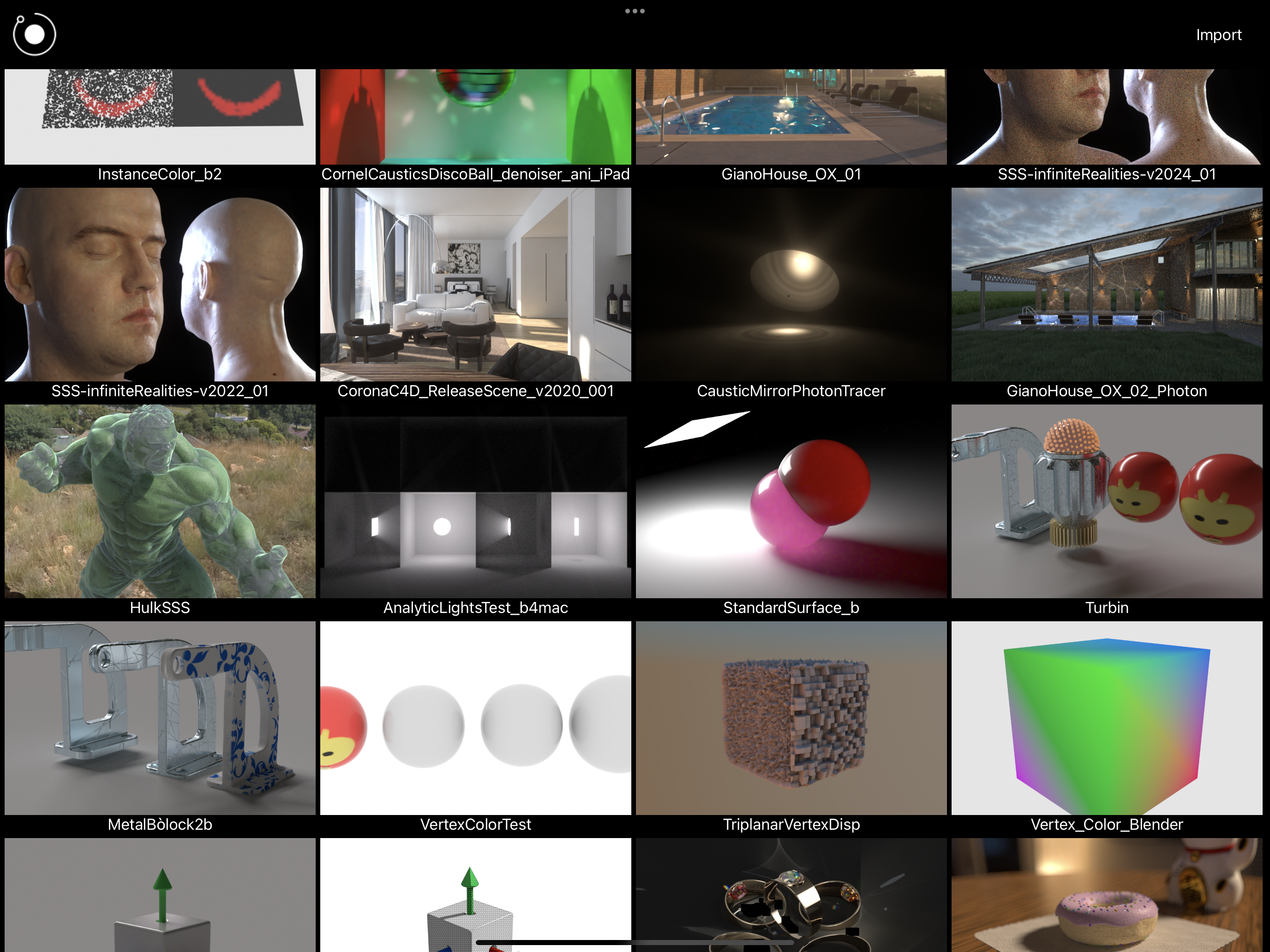

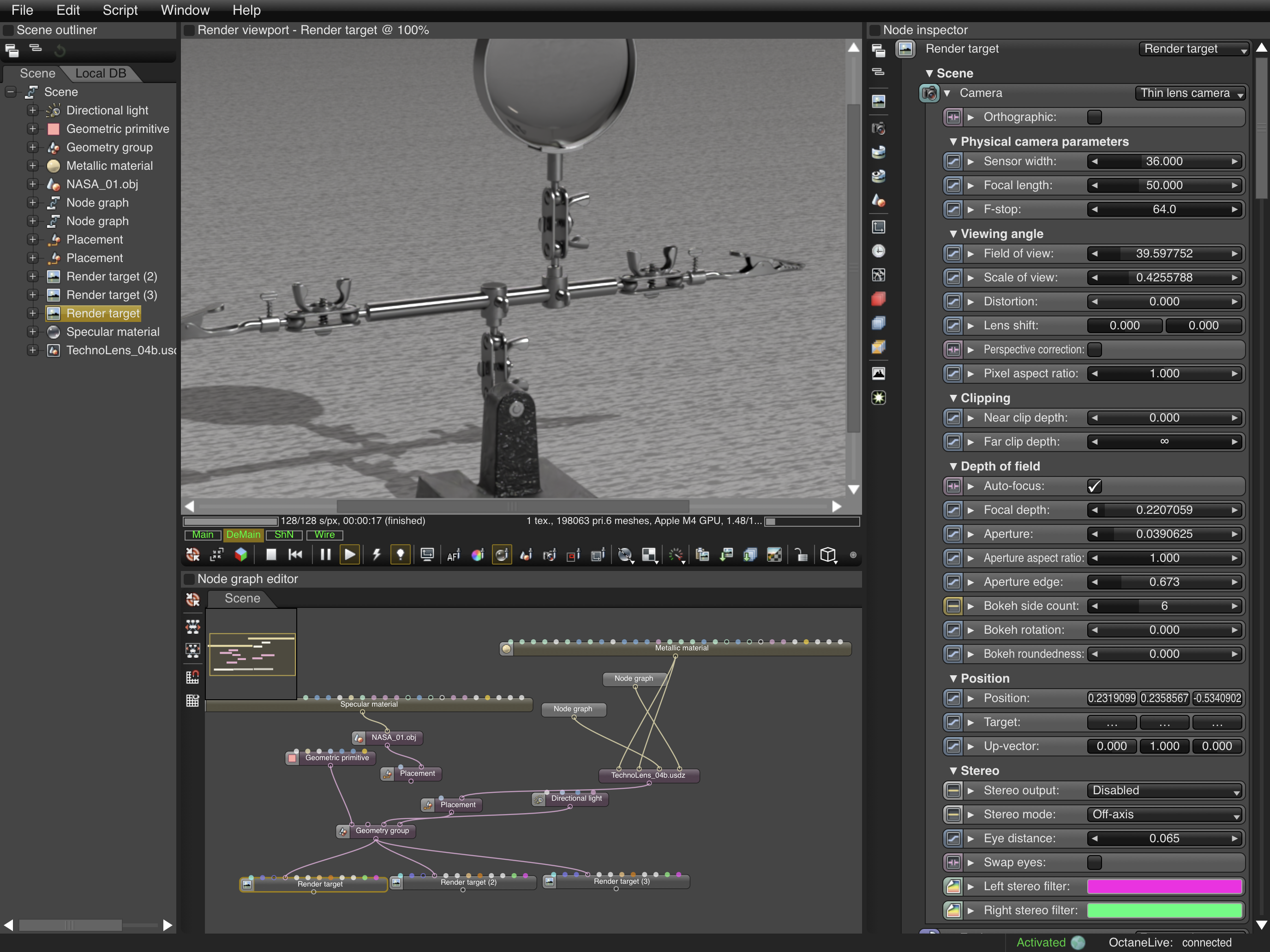

OctaneX works very well, and you can use it for checking/editing existing .orbx files, or create new scenes from scratch:
