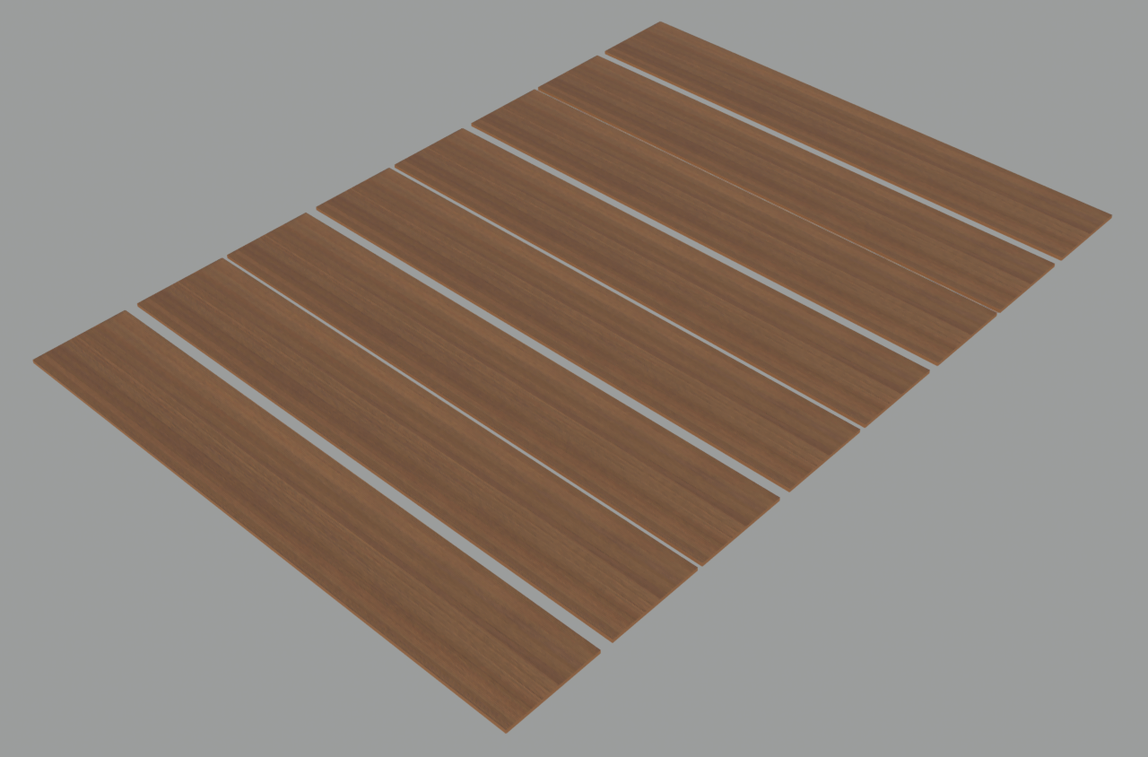

I would like to ask if someone could help me about randomize the colour of one single material applied to different copies of one objects (not blocks and instances).
In this image, all the objects have the same material (with random colour texture applied). The cubes are instances so they show correctly the different colours.
The planks are not blocks, only some copy of the same object, so they are different Polysurfaces in Rhino. There is some way to apply to that planks too one single material with variations as the instances doing? I mean, each single planks have their ID, why they don't show the random colours? There is some other trick to make this?
Roy

Hi Roy,
sorry, I’m not a Rhino user, but you need to assign a different Instance ID, in the Object Layer settings, to every block, then you can use the Instance Range node, please have a look at this OSL projection script, there is a Standalone example:
viewtopic.php?f=73&t=69211&hilit=random+osl+projection
ciao Beppe

But I don't know how to assign different ID tags to the Rhino Objects inside Rhinoceros. I mean, each object as one ID like this one in Rhino: "ID: 5a61a9cf-5977-4601-aadf-8e806e410c5e (851)" but if I apply the OSL material to all the objects nothing happens. Someone could help me with this?
