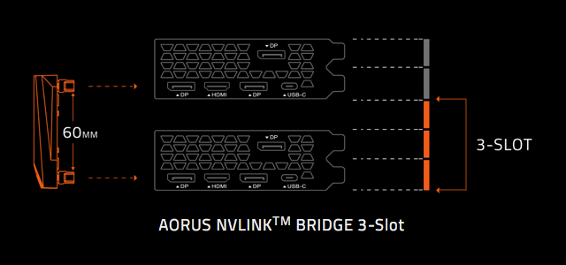

I intend to use the X399 Taichi board....has 4 PCIe 16/8 slots...and each slot is 2 slots apart....
https://www.asrock.com/MB/AMD/X399%20Taichi/index.asp
And you can fit 4 RTX2080Ti blower designs into it....which leads to 2-slots distance between cards...
According to Nvidia website there are 2-slot SLI bridges:
https://www.nvidia.com/en-us/design-vis ... k-bridges/
And from your Gigabyte link the graphic for the 3-slot bridge shows that there is a 1-slot gap between the two cards...
So my understanding is that 3-lot means the distance between PCIe connectors the GPUs are using.
My current motherboard has the two RTX2080Tis 60mm (3-slots) apart..but there is one slot accessible between those two cards...
For the plug-in problem...does it also affect the latest blender plugin?
thanks

Posts: 1157
Joined: Sat Feb 07, 2015 5:41 pm
Location: Poland
2-slot bridges are only those dedicated to Quadro and Titan - chceck compatibility card that I posted before. I have Titan bridge for two RTX 2080ti and works fine. NVlink works fine in Octane Standalone, Cinema plugin has problem. I don't know about Blender plugin.
If you don't have plans to add more cards you should leave this one empty slot because it helps a lot with temperatures.
