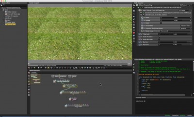

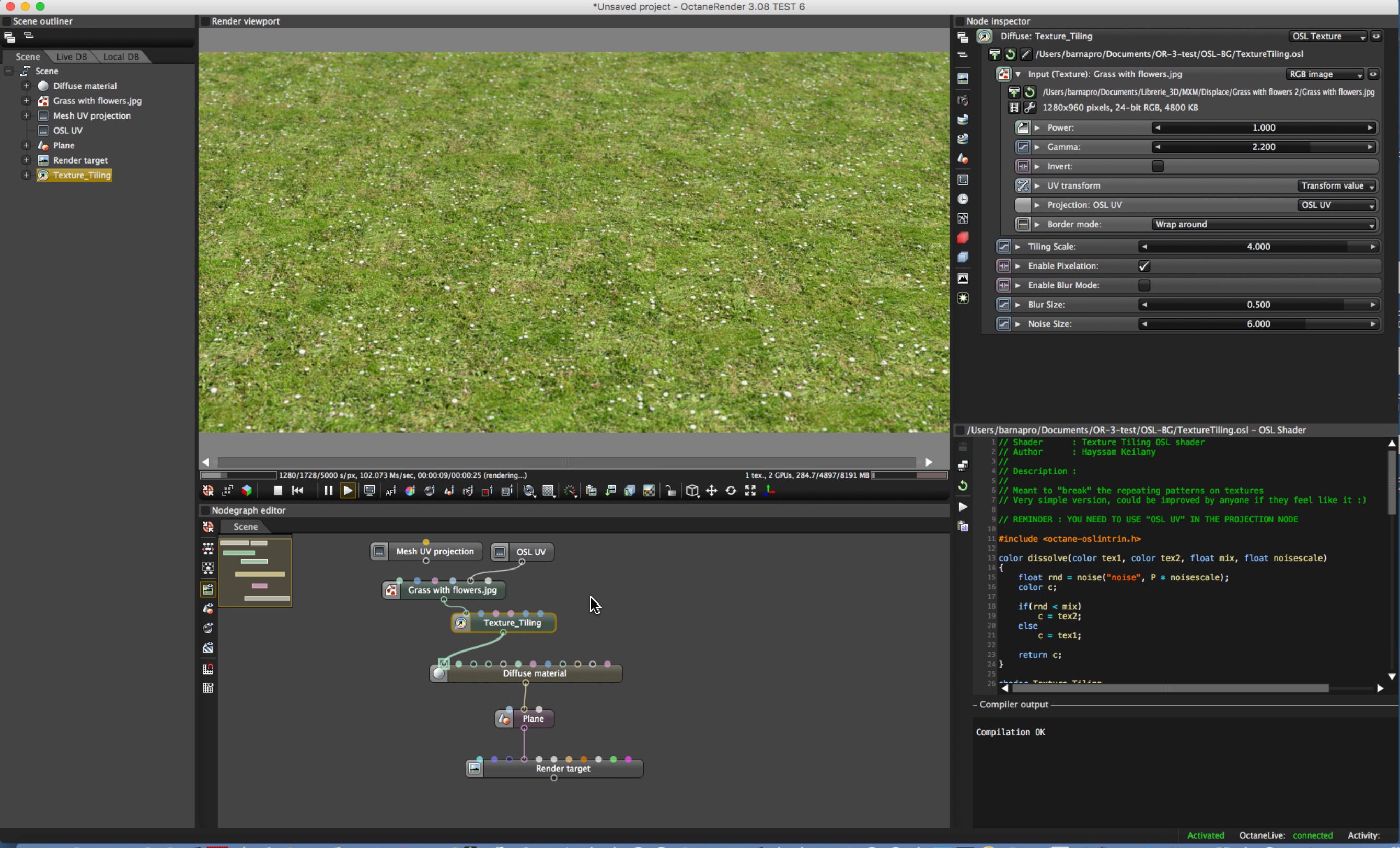

Posts: 10611
Hi franchais,
you need 3.08test 6, to try out OSL nodes.
before
before
after
after
texturetiling.orbx.zip
(2.5 MiB) Downloaded 453 times
ciao beppe

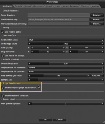

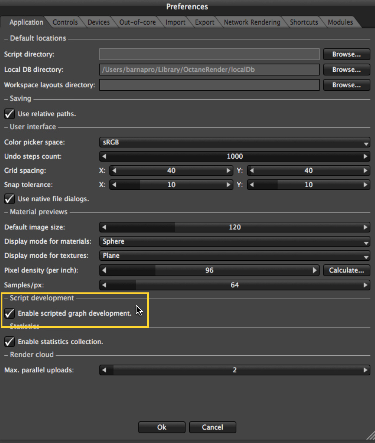

Thanks Bepe, that worked. Just one thing, where did you gett the osl editor on the bottom right of your image?
I7 2600k | EVGA gtx 680 FTW 4gb | Win 7 x64 | 16gb RAM
Posts: 10611
Hi franchais,
you need to enable the Script development option in Preferences/Application:
ciao beppe
