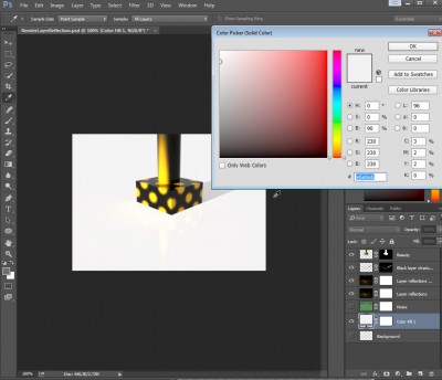

I'm sorry to re-open that post but I didn't really understand how it works.
I rendered the shadow and the reflection passes of my Render Layer but when I comp in photoshop I get a full white reflection (even with a slighly gray BG). It seems that I can not get back to the original look. You can see the picture attached, showing the live viewer render and the photoshop compositing side by side.
Thank you,
J.

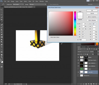

Hi Beppe,
It is even worse, see the pic attached :)
J.

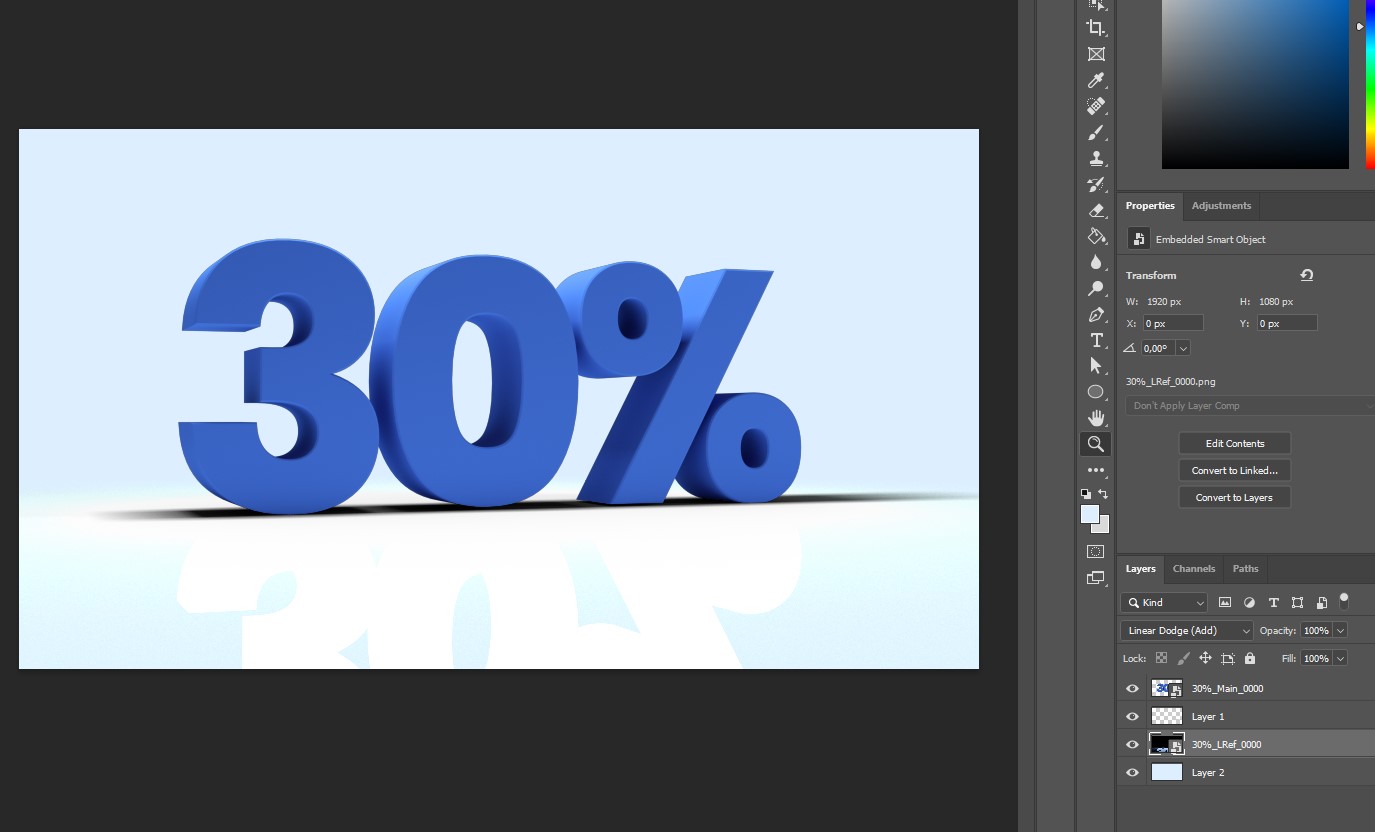

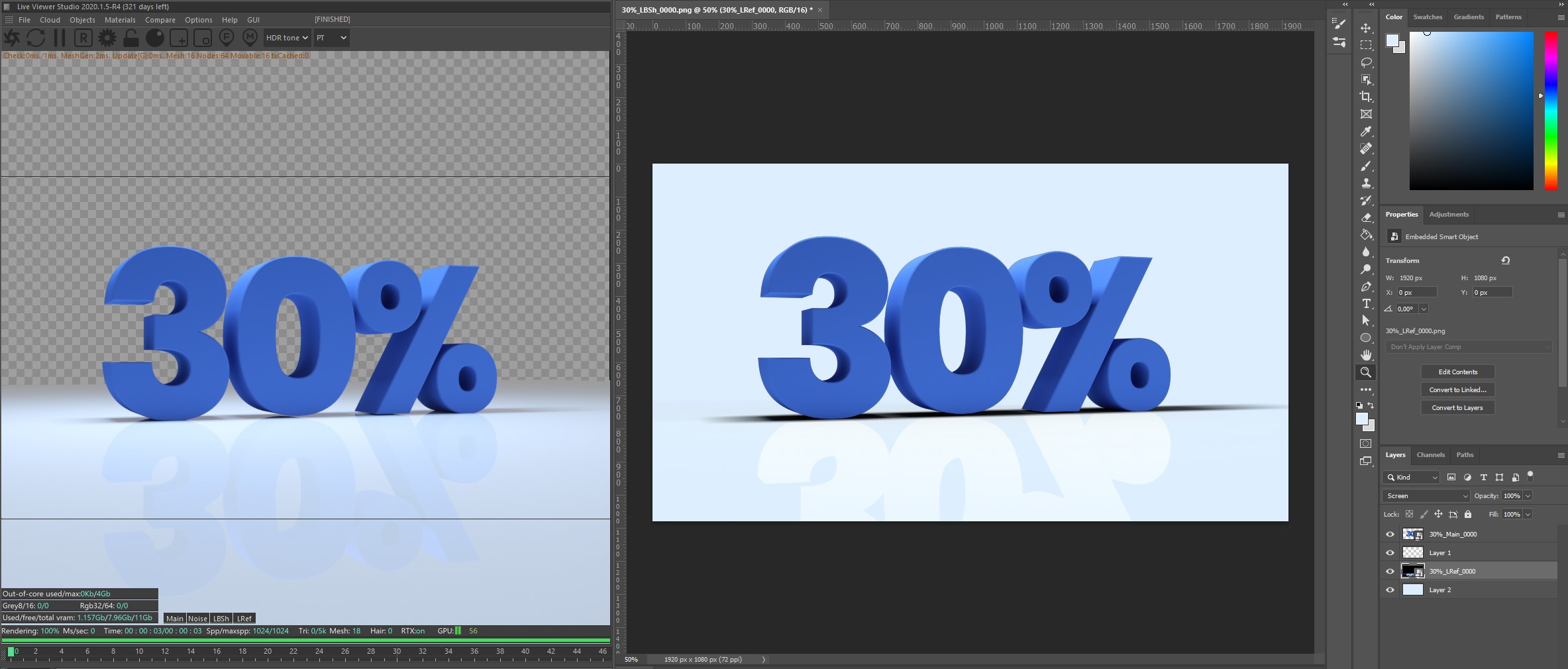

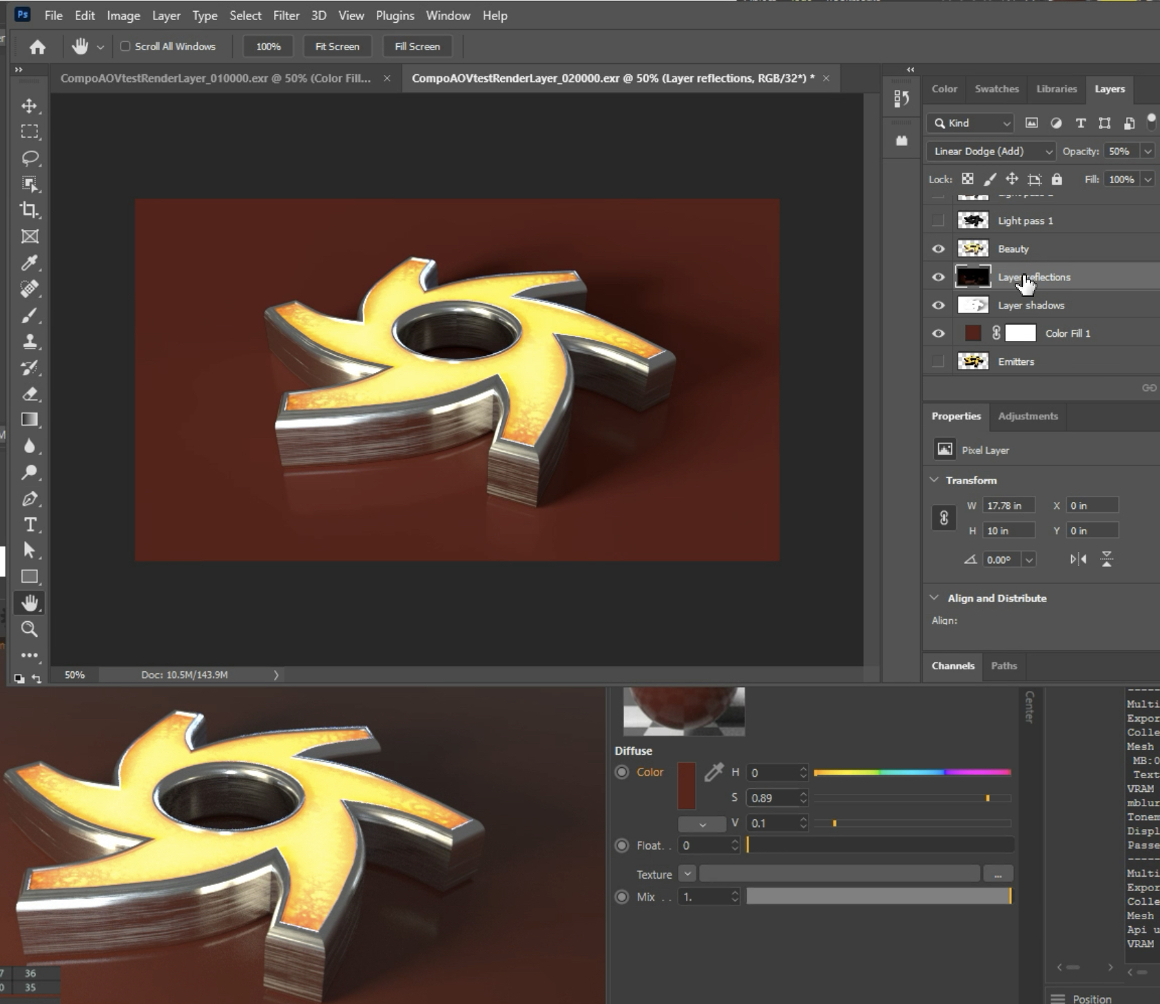

Posts: 10563
please try with 2020.2-RC6, Linear Add 50% seems to work correctly here:
ciao Beppe
