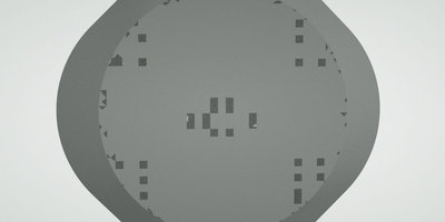

I know some of you guys use MoI. Can you please look at the following simple model I made in MoI and suggest a good combination of export/import settings that won't produce odd rendering issues (see screenshot attached)? I'm fairly inexperienced in all this (both modeling and rendering) and I feel like I'm just missing some obvious information on how to avoid this kind of problems, or how to analyze what's happening and why.
Thanks!

have you checked the scale?
do you export in meters?
also make sure all your exported faces are triangles, not n-gons,
there should be an option to disable it.
also check the manual i think there's a screenshot of the MOI3d export config in there.

Im a MoI user myself (seriously a good software ;) )
You need to export in Triangles only, no quads, no ngons.
Also try to set your units in MoI as meters, so you don't need to change anything in Octane
By looking at your screenshot I see a scale problem + that you used quads + tris

I'm exporting in meters yes. The object is about 20x40 meters big in MoI. Is that too big? Too small? What's a good scale?

candide wrote:I'm exporting in meters yes. The object is about 20x40 meters big in MoI. Is that too big? Too small? What's a good scale?
should be good, but check the triangles export option as sam said...

Okay, after playing with various scales and exporting as triangles only, I seem to have a clean render now. Thanks!
