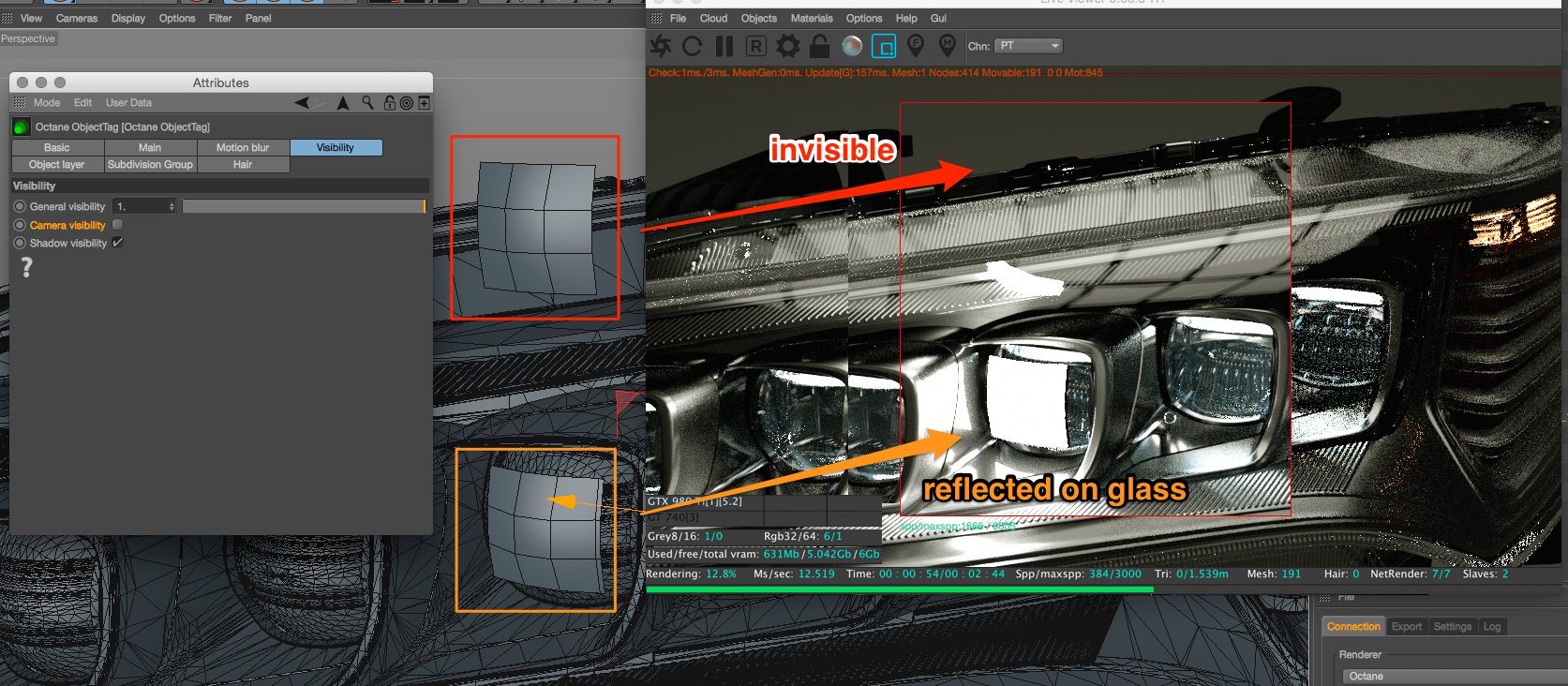

Hi Beppe,
Thank you for the reply.
Yes the cast illumination off did help some, but I think I'm missing something with the polygon in front of the bulb to do the illumination.
Even after unchecking camera visibility, the poly is reflected right back onto the bulb.
Thanks,
Daniel
