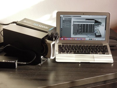

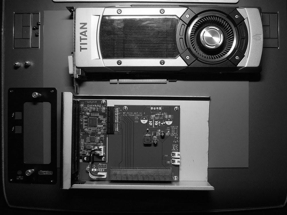

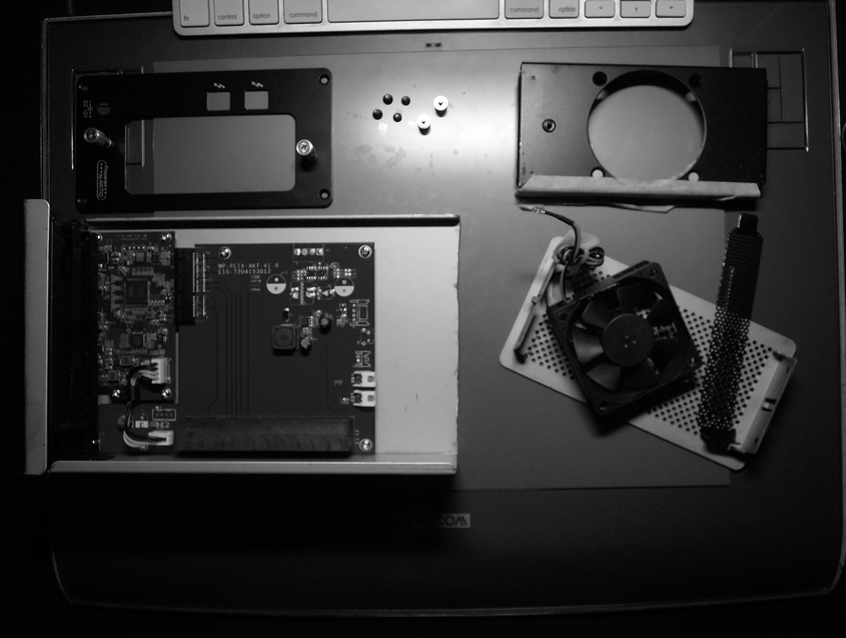

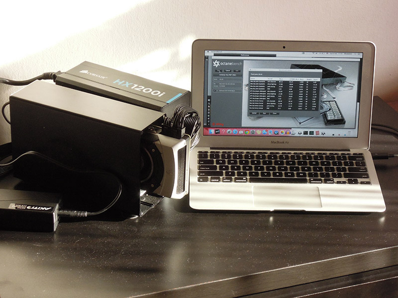

prodviz wrote: What would be the best route to go down, for testing purposes?
akitio might be the most simple solution for now =)
Using SFXL solution might be good Idea:
Having PCIe ribbon cable to displace GPU migh help as well to avoid case modification in the beginning
Here is how solution looks with back of the Akitio modiffied to allow accepting long cards =) works even with MacBookAir..
Hope that helps =)
