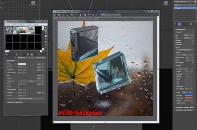

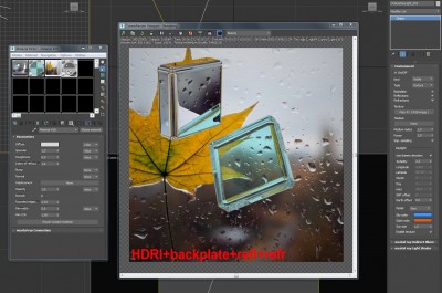

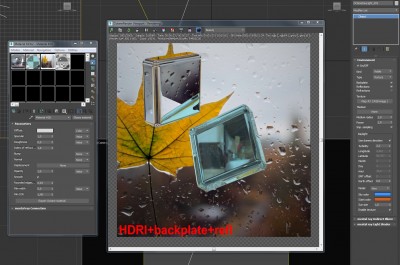

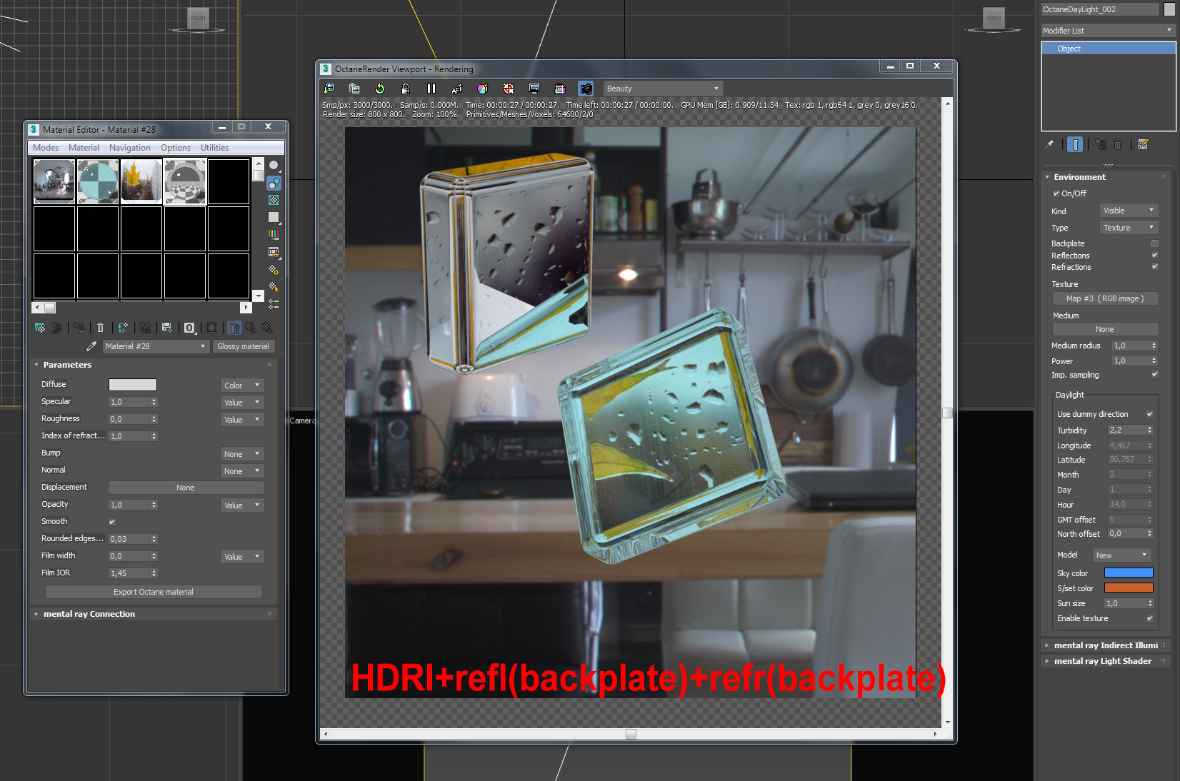

paride4331
Posts: 4004

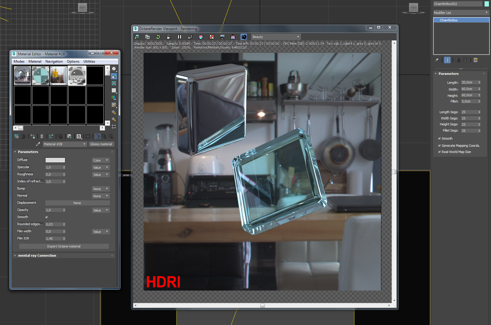

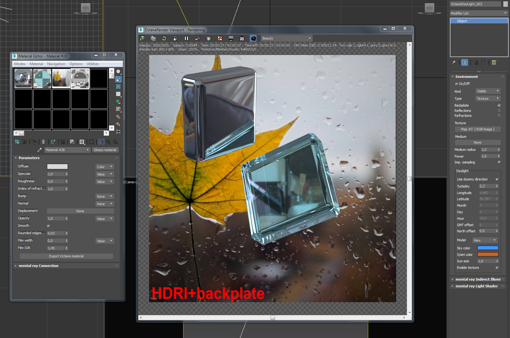

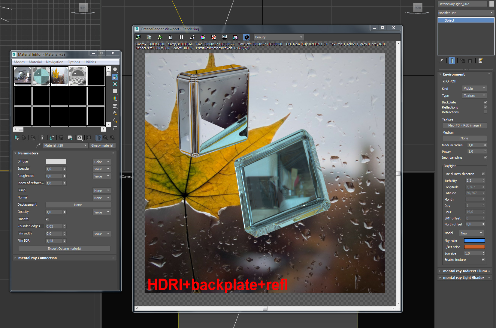

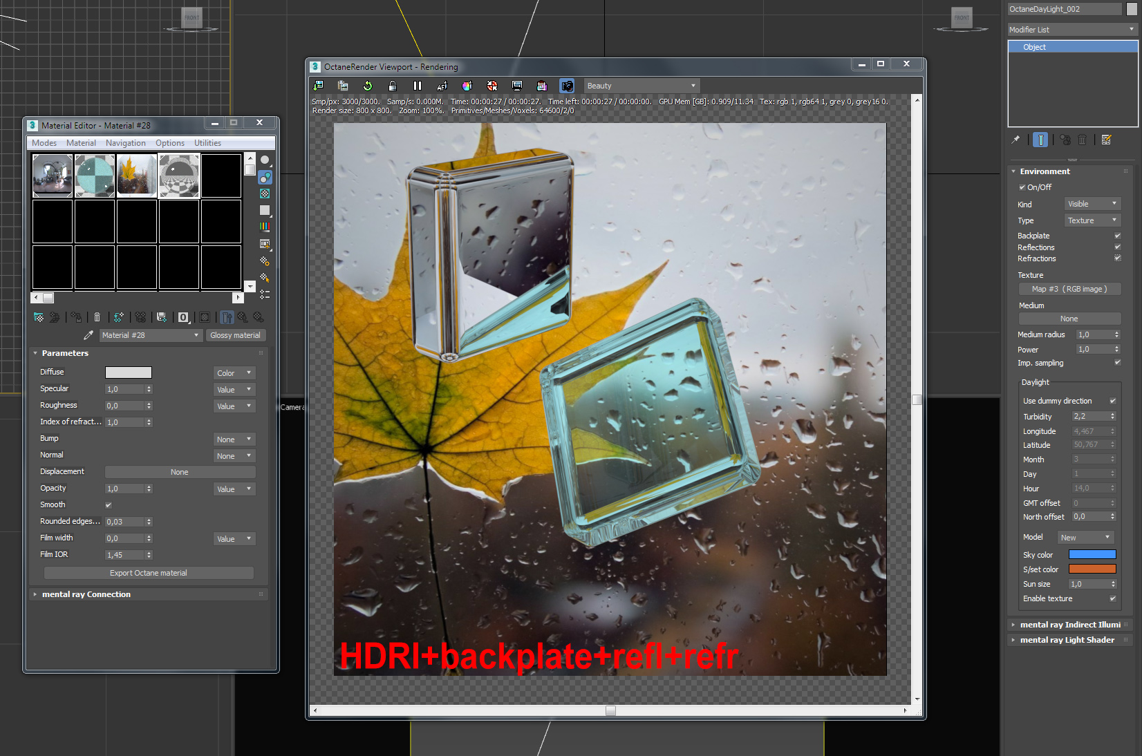

Hi justix,
you can make it in composite, but you can make it with Octanedaylight, directly in Octane.
you can choose hdri, backplate, relfection or refraction to use on stage.
Mix them as you wish.
Regards
Paride

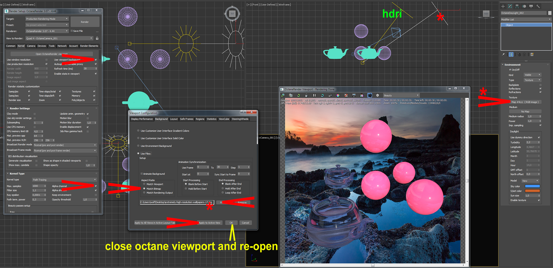

Hey Paride
Thanks for your help. One thing though: when i put my rgb image into the daylight texture slot, it always wraps around in my background. Like it interprets it as a spherical map. i want it to be 2d planar though, like in my viewport.
https://www.dropbox.com/s/y524f7byoqxm6 ... d.png?dl=0
Regards
Robin

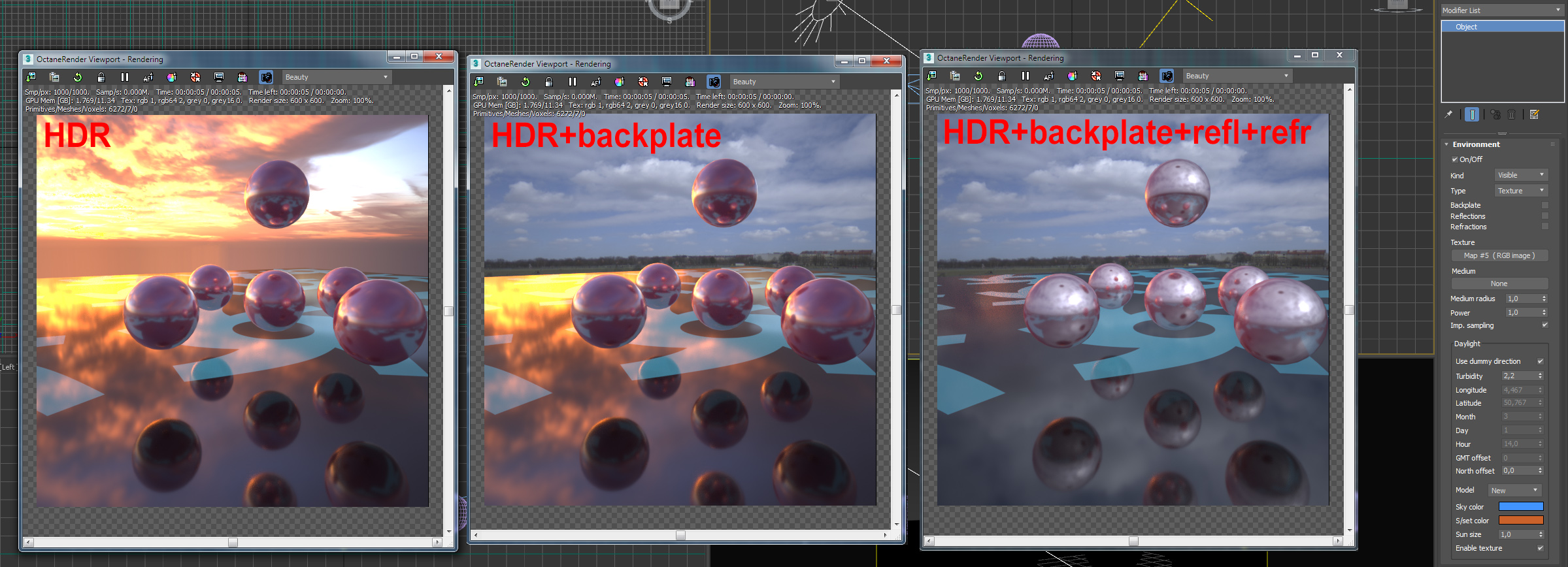

paride4331
Posts: 4004
Hi Dischtance,
this workflow is not mathematically true, but very fast and acceptable in many cases.
could it work for you?
Regards
Paride
MaverikMS2001
Posts: 8
Joined: Sat Nov 29, 2014 9:19 pm
The last technique dosen´t work for animations. How can i combine a HDRI in Enviroment slot with a backplate ?
The use viewport option works only on still renderings.
