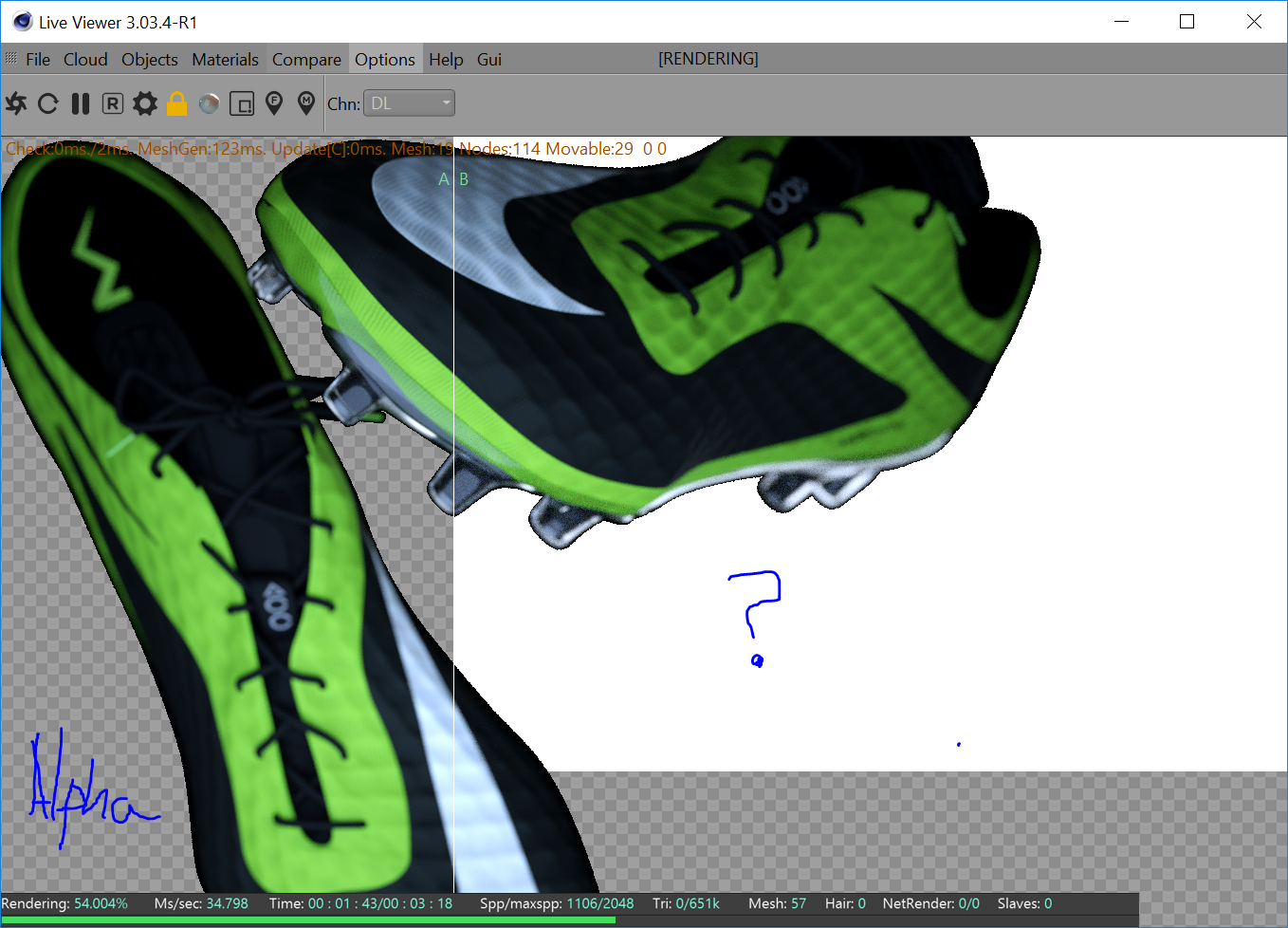

Location: Seoul, South Korea
A/B Compare have some problem.
I use show alpha option. Empty-BG will turn white.
If possible, add horizontal compare mode. :)

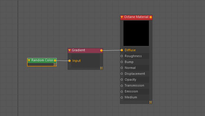

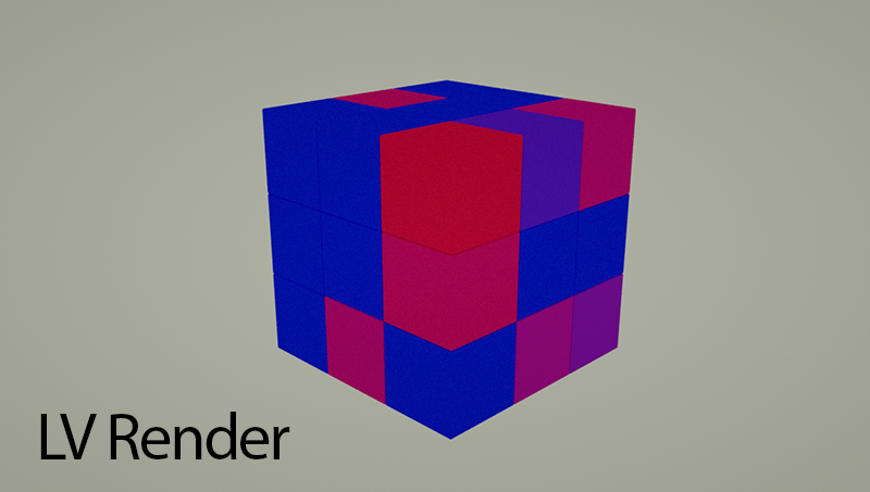

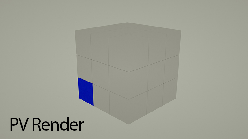

Hi aoktar,
I have the feeling since V3.03.3-R1 the Random Color doesn't work correctly anymore.
It renders fine in LV but makes problems in PV Render.
Am I missing something?

matpr wrote:Hi aoktar,
thanks for yor amazing work!
cheers m
Thanks. It's working but need a object tag. I'll add this to "auto detect option".
EDIT: Well! I think there is a glitch if you don't put material to object of clones. It can be a bad-effect of revisions for material-mixing. I'm trying to fix.
