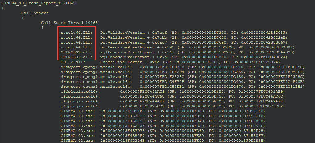

I am still can not use it! Cinema 17, 18, 19 crushes, when i start it with this plugin in the c4d plugin folder. I already post my bug report here, and haven't got no answer.

MikhailTkachenko wrote:I am still can not use it! Cinema 17, 18, 19 crushes, when i start it with this plugin in the c4d plugin folder. I already post my bug report here, and haven't got no answer.
Did you read install notes? This is from you bugreport, i don't see anythings there about octane.dll.
