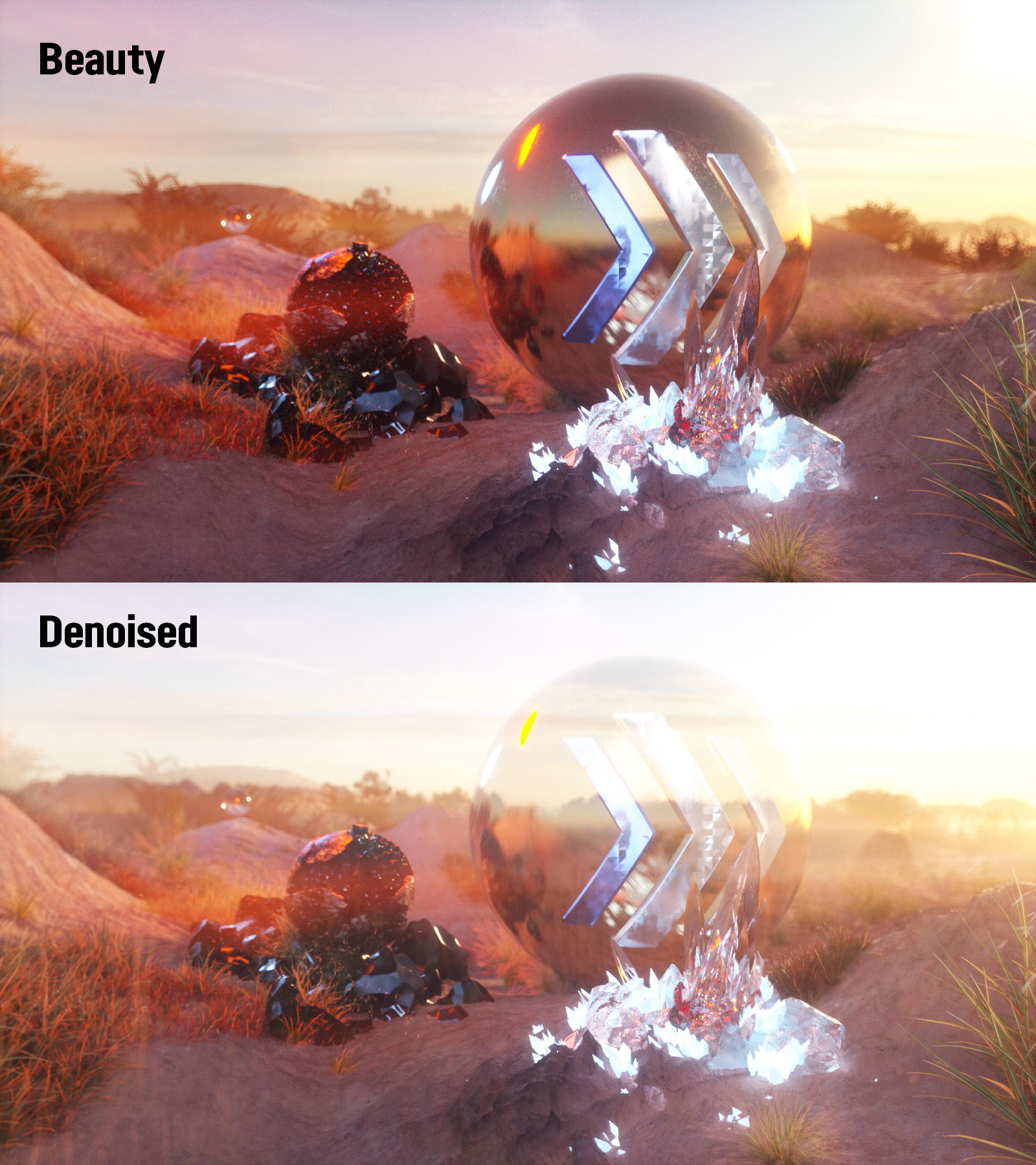

I get strange results after denoising on this scene. Reminds effect of double exposure in photographing.
I attached the scene file.
https://yadi.sk/d/wt_ypowIaE8ydw

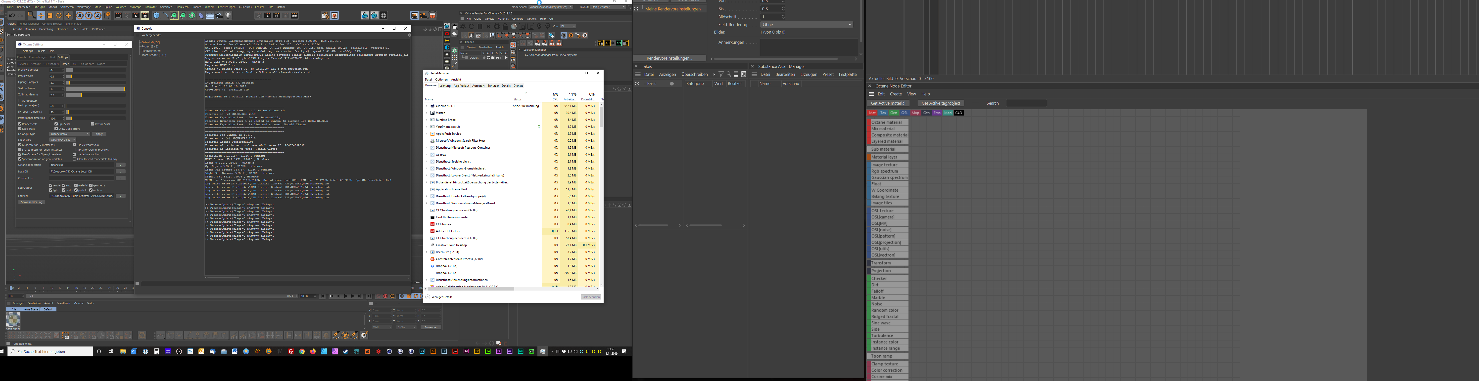

nVidia StudioDriver is 441.12.
Attached is a screenshot of the state after c4d freezed. Making a video is impossible atm because the freeze happens if the mouse hovers over NE window which sits on a second screen.
Master: WIN 10 64bit, i7 4930 4,5 Ghz, 64 GB RAM, 1600 W PSU, 1 TB SSD, 14 TB RAID, 2 x RTX 3090
Posts: 16068
Location: Türkiye
Ron wrote: nVidia StudioDriver is 441.12.
TRY THESE
1-Downgrade to Studio 431.84 with CLEAN install
2-Use a default layout
3-Delete prefs folder for testing and remove all other plugins for testing
