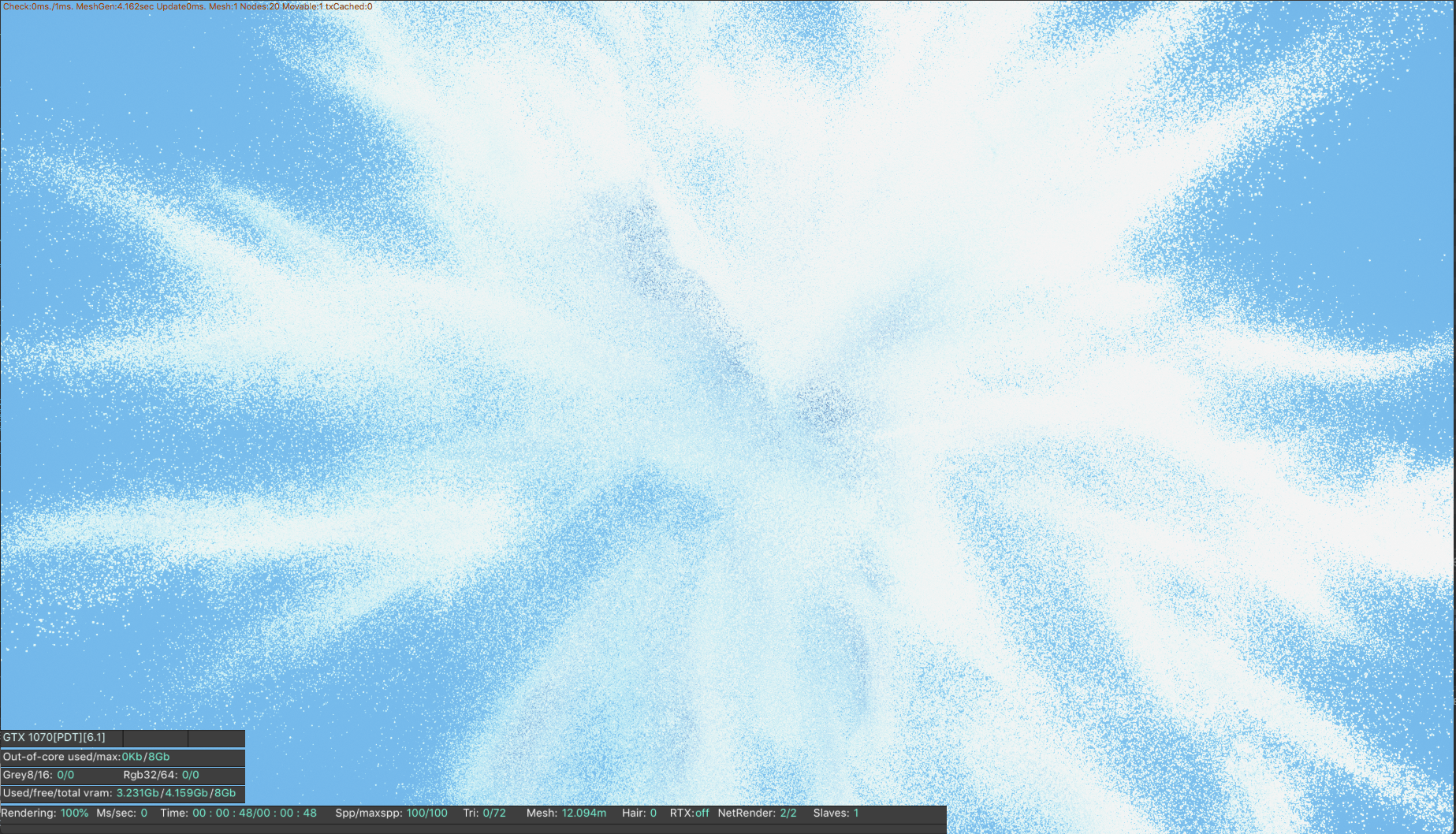

Hi. I have a problems every time when i use huge particles amount. 10 millions and more. Octane just crush. I can't work.
Just simulate 20 frames and try to render. I will again have to switch to redshift. Can you already do something to make the octane work?

frankmci
Posts: 917
Location: Washington DC
divasoft wrote:Hi. I have a problems every time when i use huge particles amount. 10 millions and more. Octane just crush. I can't work.
I wrote to you about this problem several times over the past 2 years.
Scene https://yadi.sk/d/0k090xST2uxJQA
It seems to render fine for me, even on an old GTX 1070 with 8 gigs of VRAM. Are you working with some tight memory limitations? The C4D UI does get a little sluggish with that many particles, but the rendering doesn't seem to be a problem. If you turn down you Parallel Samples you can get a bit more headroom, memory wise, with a small hit on render speed. Here's frame 20 of your example scene:

Can you explain what the problem is? Ask me for bug reports or something else. Yes, sometimes octane can render this scene, but in half the starts I get a crash. Once again, it’s not possible to work like that. Instead of excuses, can you help me with something? When I refer to redshift team, I always get accurate explanations of what the problem is, or they just fix it. From you, I usually hear that the problem is not in the plugin. What is the problem then, how to fix it?
