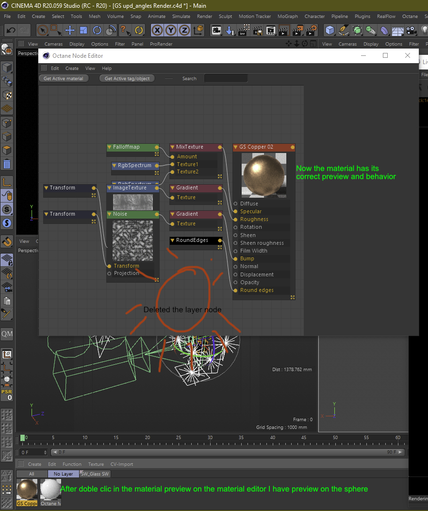

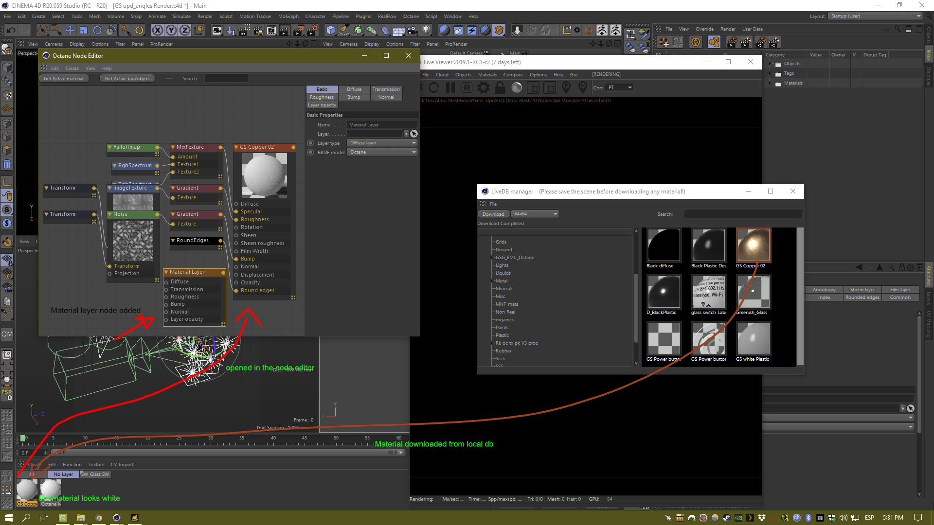

omardex wrote:
SRCOBB wrote:I notice that the materials in live DB and my local DB don’t work anymore.. they download. The images are there. But the materials all show just white. Any idea why?
Hi I noticed that too, open the node editor and delete the layer node that appears there
I'm not sure what we are talking about! Any picture or video to show it?

aoktar wrote:
Sure check the attachments... the materials downloaded from the local db in my case renders and previews white, deleting that additional material node restores their previous look

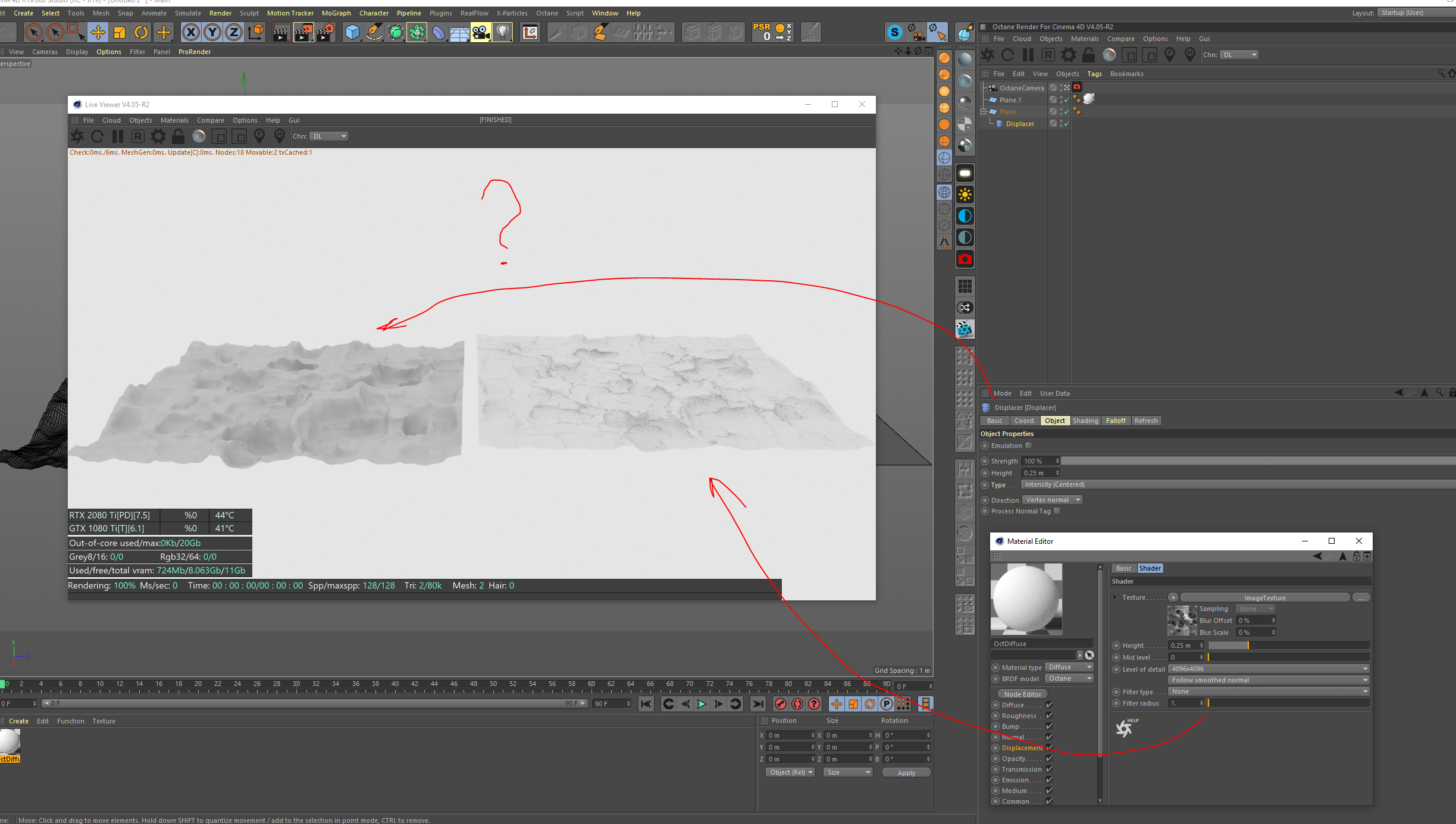

Why displacement obtained using the cinema modifier different from the displacement obtained using the octane displacement?
How should I place objects on a plane if I don’t see where to put them in the viewport?

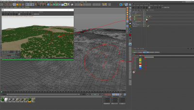

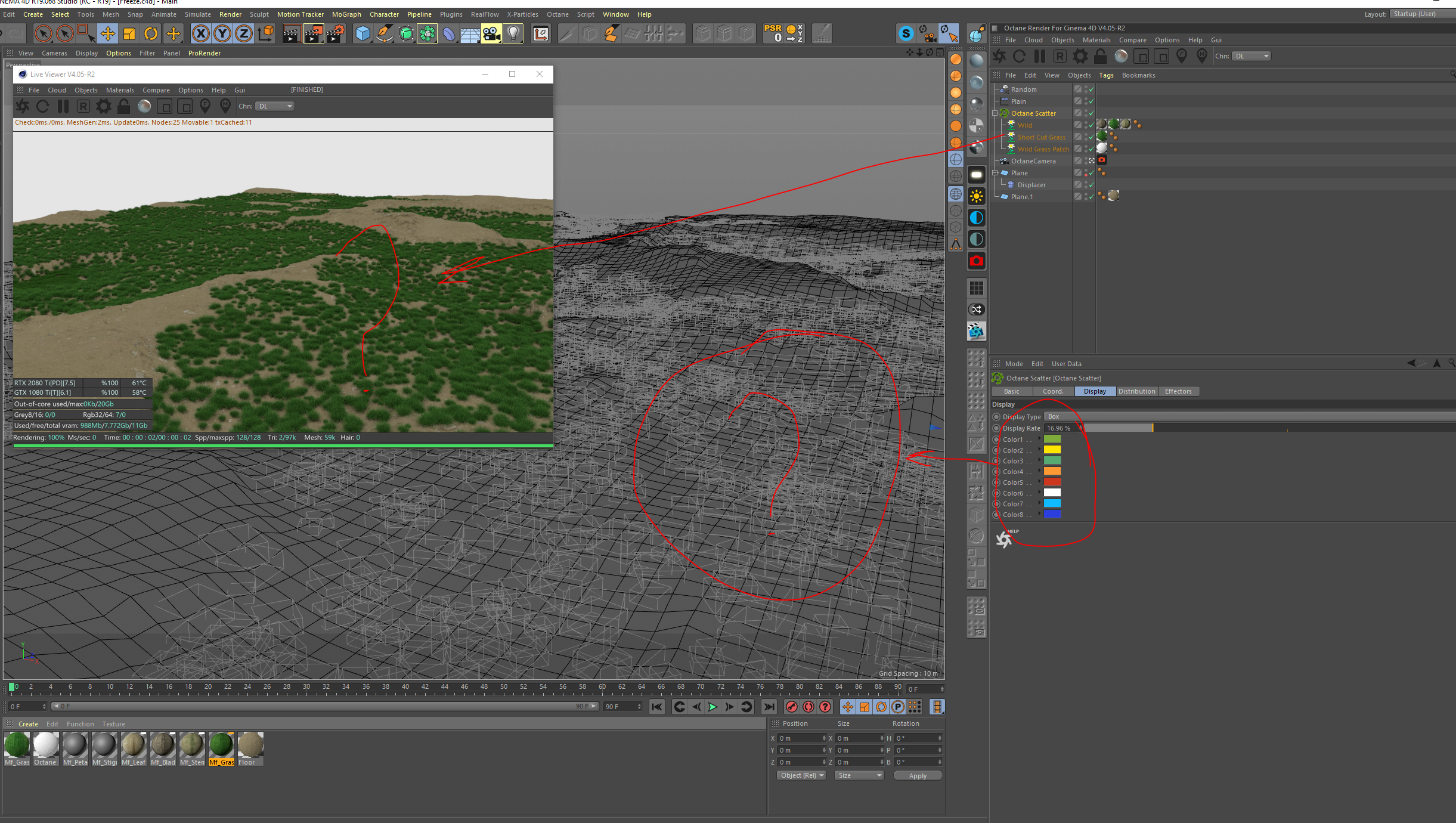

All scattered cubes in viewport are gray and scatter use only first object for scattering when i use cinema effectors with octane scatter.
