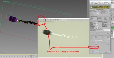

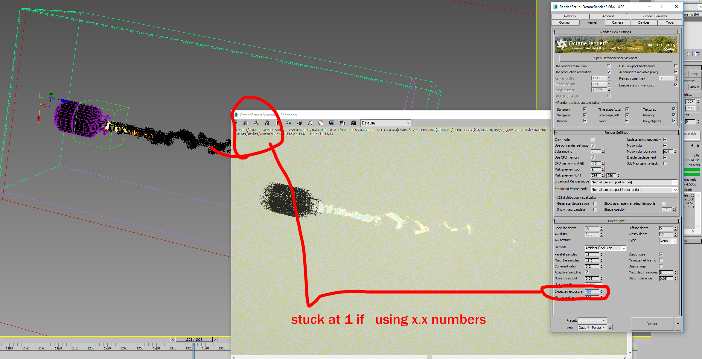

Not sure if this was addressed and otoy is fixing it. viewport still gets stuck at 1 if expected exposure is set to decimal number.
It will open viewport fine but once you move camera around octane viewport stops at 1
stuck at 1 with expected exposure

Here is the video attached. As soon as exposure is set from 1,2,3,4,5 to 2.3 or something like this it gets stuck at 1

Thanks, I have encountered a similar issue with decimal values, no stuck but an Octane Render Viewport.looping refresh parameters.
I'll add your stuck issue to 3ds Max developers.
