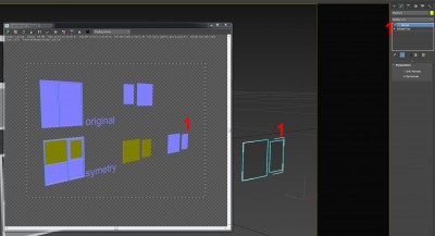

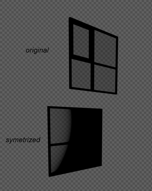

I just saw that with 4.30 symetrized geometry ( specular material ) have a refraction problem. Higher is the Index of refraction more visible is the problem.
Glass have thickness. with IR = 2.0
Hope that can be solved quickly.
EDIT :
After some research,s the problem occur if :
- the object is not movable proxy
- specular have smooth unchecked
Symetrized geometry problem

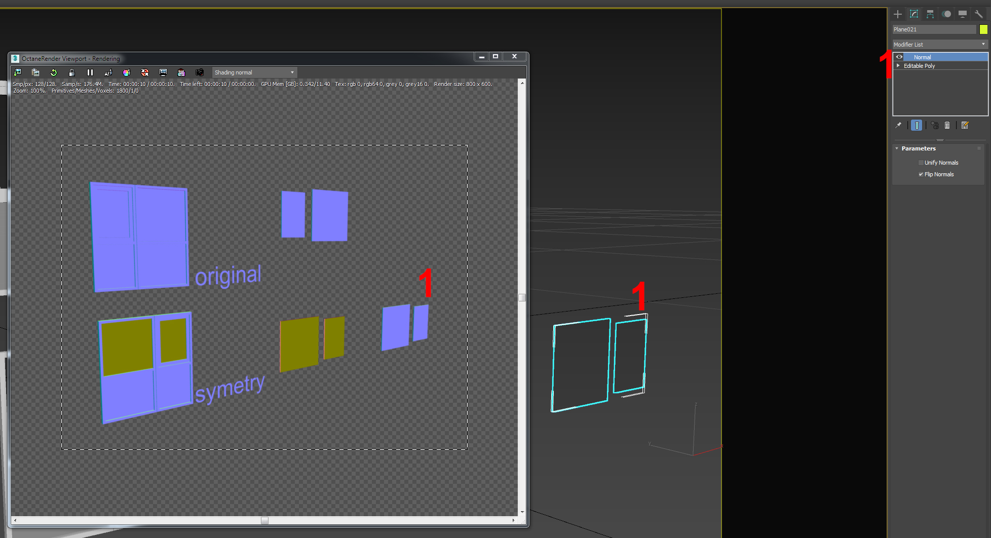

Hi HHbomb,
have you tried to flip the normals?
Regards
Paride
Regards
Paride
Hi, thanks for reply. But as it is instances I can't flip normals.
