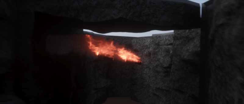

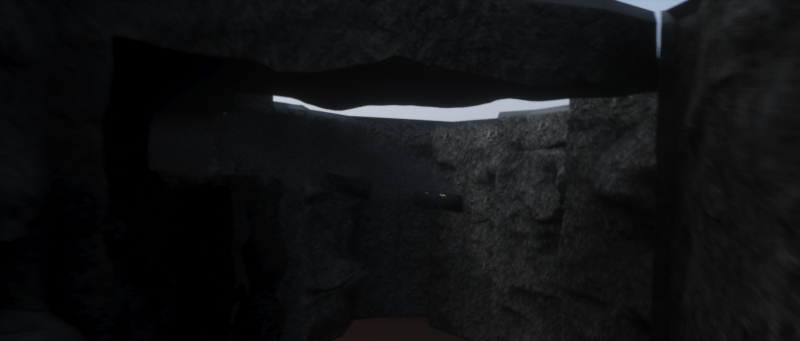

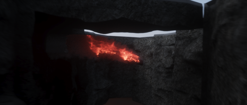

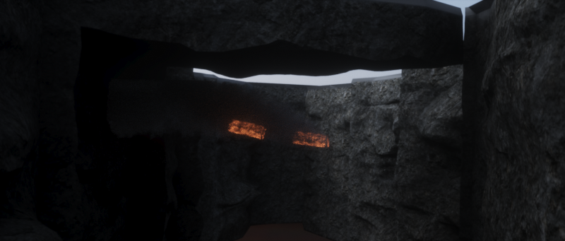

VDBs Rendered fine with a little tweeking in 3.14
now in 3.16 they wont render Fire like it used to in 3.14 only when increasing the emission scale 10 Times Fire shows up at all.
3.16 seems to "Match" to the original Object better though..
se comparison
System:
Win 7 64
Nvidia Driver 368.39 GTX 780
Max 2016
Octane Standalone 3.02
3.16 with Emission increased from 350 to 3500
3.16 nothing changed from 3.14
3.14
3.14

Fixed It !
Looks Like something has changed in the Channel ID's of the Octane Vollume Object.
Would be nice if we could add multipe Channel to one Slot for Example " Temperature and Fuel" in the Emission Slot.
And in adition to this:
Motion Blur needs a Fix aswell. I have a "Moving" Fume Grid and when rendering in octane Volume"Parented to the FumeGrid" its just a Blob.
Previous Volume Settings v3.14
Absorbtion scale - 1
Emission scale - 380
Scatter scale - 1
Velocity scale - 1
Absobtion " Smoke"
Emission "Fuel"
Scatter "Smoke"
New Settings for v3.16
Emission scale - 4
Scatter scale - 1
Velocity scale - 1
Absobtion " Smoke"
Emission "Temperature"
Scatter "Smoke"
3.16 Fixed
3.16 Fixed
Win 7 64 | Geforce GTX780 |Dual X5667 Xeon | 40GB | MAX 2016 |
