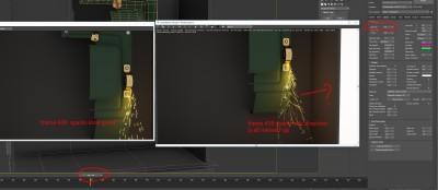

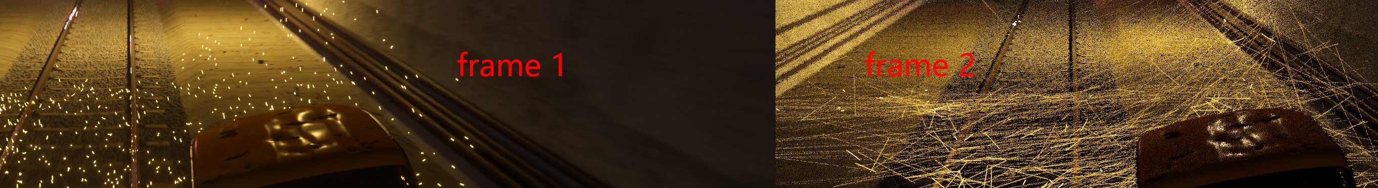

Why is motion blur still not working right with particles (super spray, pflow). After so many frames it does this. It's been since Octane 2. We really try hard and report problems for you, guys, but some get ignored and the problems pile up.
Do you even test animations?

Hi Paride,
here is the scene.
There are two bugs:
1. If you start rendering at frame 429 you will see no particles being rendered.
2. Please start rendering at frame 430 and you will see incorrect mb at frame 440.
Thank you

Hi Paride,paride4331 wrote:Hi coilbook,

were you able to reproduce these two problems with particles?

Hi coilbook,coilbook wrote: There are two bugs:
Thanks for your scene.
-The first issue will be fixed in next release, 7.01
-For the motion blur, do you mean a blur that should not there there ? I see some blur on the lever at frame 440, but it's not due to motion blur (as it stopped moving at frame 439), I think it's just camera's focus / aperture.. (setting Aperture to 0 makes it clear..)
Thank you

I've reattached the scene. please go to frame 439 and you will see incorrect motion blur of sparks where in 438 it is ok. It has nothing to do with camera or the lever. Thank you.

were you able to reproduce the incorrect mb problem?
