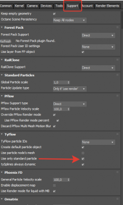

tcheng00 wrote:Hey guys,
I exported my tyflow particles and loaded it back in using the Tyflow Cache. However, i'm not sure how to get it to render. I Enable Particle Interface on the Tycache, but that didn't seem to work. Is it supported at this time or did I miss something? Thanks.
viewtopic.php?f=27&t=74783
I got it to work fine with the Tyflow particles from that article, but the same article doesn't say anything about the tyCache use. So the article doesn't seem to apply in this case.

Hey tcheng00, try to mark this item, save the project and reopen it.
tyflow
tyflow

Sidches wrote:Hey tcheng00, try to mark this item, save the project and reopen it.
Looks like I just needed a tymesher set to input geometry mode for it to work. Not sure if that means all my instance geometry becomes unique.

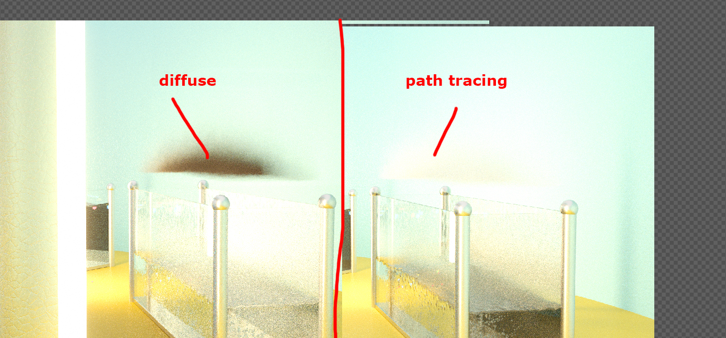

Hi Paride,
please fix old volume behavior. It still makes phoenix fd smoke almost black in AO mode
Also you cannot have white smoke anymore. It has a lot of black because the rays dont penetrate it well. Old versions didnt have it

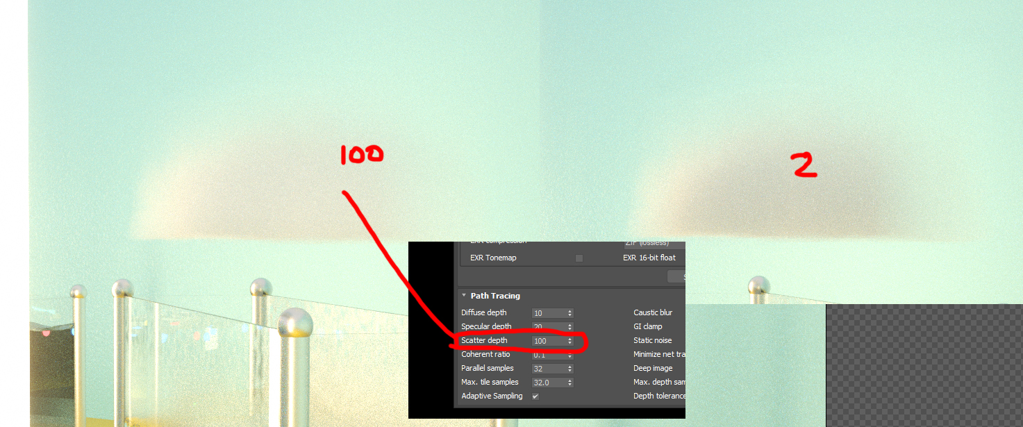

I think bug is when using diffuse/ao, PAthtracing has nice white smoke
It looks like pathtracing has scatter depth and diffuse kernel doesnt. Can devs add it?
THanks
