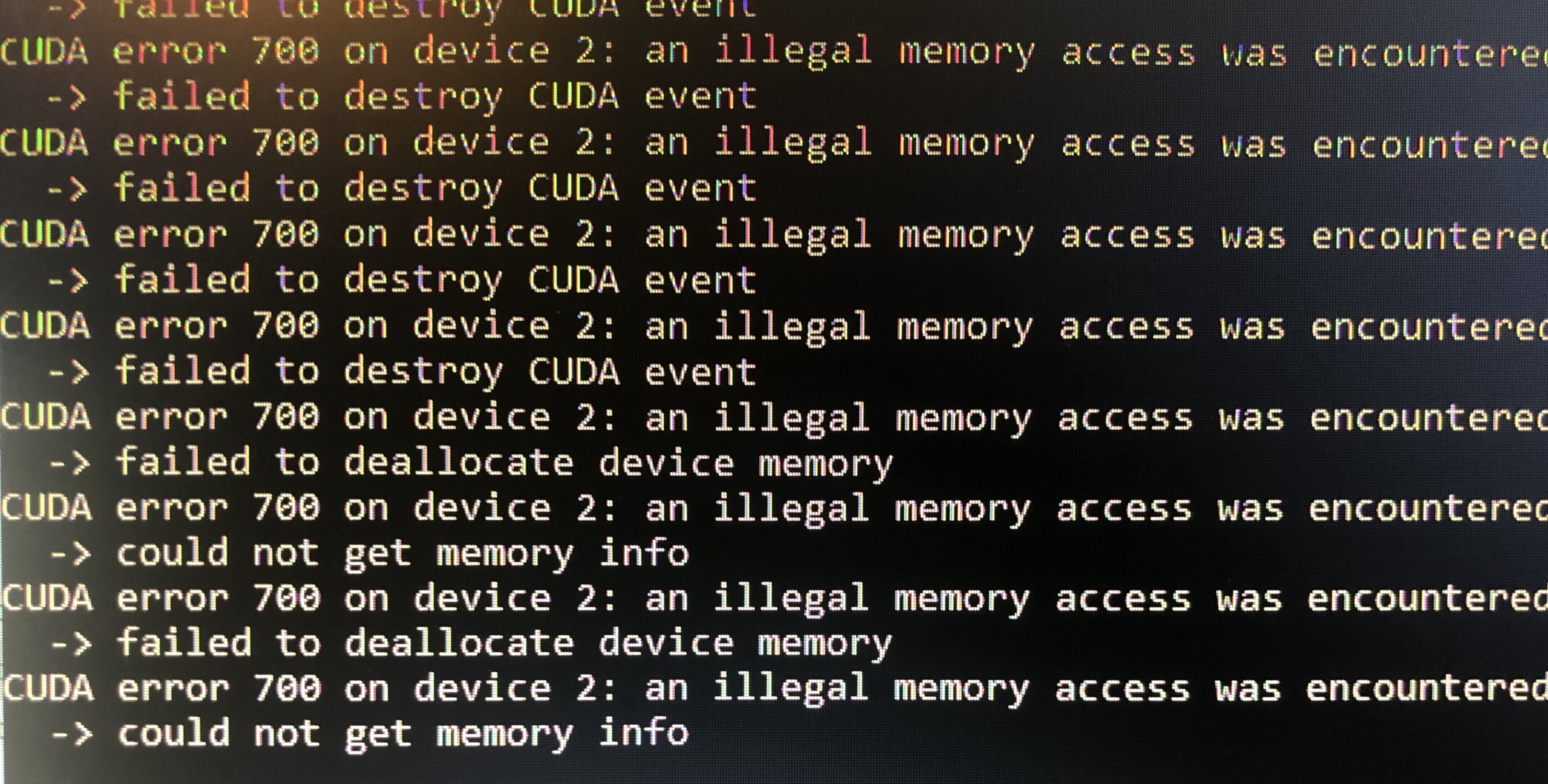

one of our slaves just crashes when using RC versions. Slave has 2080tis ans titans mixed with cuda error and failing kernels. The slave that has all Rtx cards 2080ti works fine
