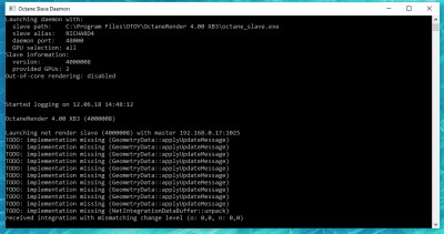

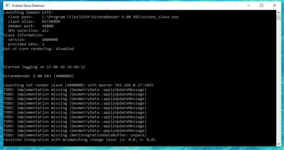

NETWORK RENDERING ERROR
What does all this mean ? Trying to network render with two other machines using the DAEMON.
richardyarlett
Posts: 197
Joined: Thu Apr 09, 2015 8:48 pm
This is all I am getting when trying to network render...
TODO: implementation missing (GeometryData::applyUpdateMessage)

Note: the network rendering is currently disabled for V4, it's still a work in progress.. XB is eXperimental build, not all features are supposed to be implemented ..
