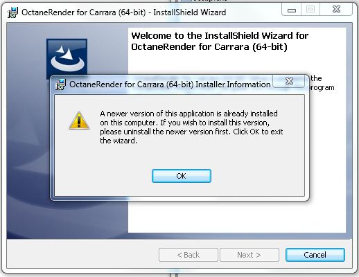

Thanks for the update, had a bit of a install issue. Previous versions would overwrite or uninstall before new version installs but now I get a error and nothing installs. I will manually uninstall or wait a few just in case there was a change in your installer.
Install error 66
Install error 66

That's because you are installing 2.17 on top of 2.21. 2.17 is the Stable release of 2.1. You don't want 2.17 if you are moving forward with 2.21.

LOL Read Slater READ! Sorry about that, got too excited about new toys!
