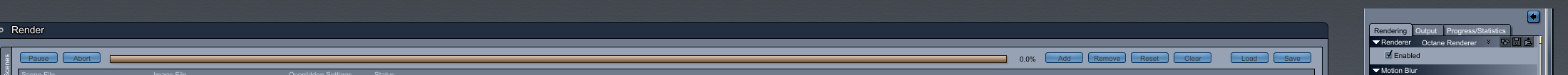

And, after an initial hitch, the RenderRoom is now working. Initially, when launching an Octane Render from the Render Room, in either batch or direct, there was no activity.
By that, I mean, no render window, and no error messages, no freeze. Attempting to pause, or abort resulted in greyed out options (attached). Now here is the weird part......
Now the Batch Queue is working. After trying twice, closing after failure......in trying to give you more details, I tried again. This final time, I was able to reset the render and launch the batch queue successfully!

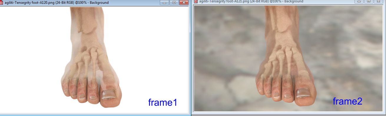

HDRI file not loading for first rendered frame in batch queue. Please see attached, where frame 1 is actually frame 120 in the sequencer, but the first frame of the render. Please see missingHDRIframe1.png.

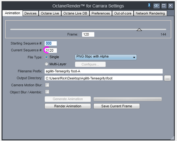

Unable to designate starting sequence in Octane Render (not batch queue). Even though I designate 3 digits for Starting Sequence, 4 digits remain showing for Current Sequence. This dis-syncs renders with Sequencer, messing up file correspondence with video editor. Please see sequence indication adjust.png

That's weird, I'll look into it.protovu wrote: HDRI file not loading for first rendered frame in batch queue. Please see attached, where frame 1 is actually frame 120 in the sequencer, but the first frame of the render. Please see missingHDRIframe1.png.
I'll add a preference that allows you to specify the number of digits in the sequence number.protovu wrote: Unable to designate starting sequence in Octane Render (not batch queue). Even though I designate 3 digits for Starting Sequence, 4 digits remain showing for Current Sequence. This dis-syncs renders with Sequencer, messing up file correspondence with video editor. Please see sequence indication adjust.png
