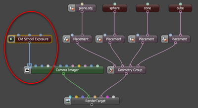

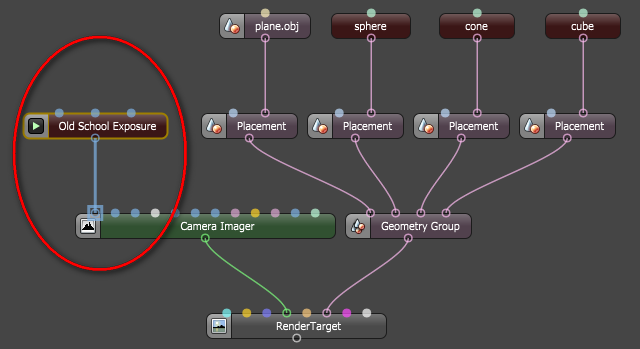

Hi all,
Since some people miss the old school exposure settings for reasons that are totally beyond me, I have whipped up a little Lua node graph that emulates the old exposure settings:
old_school_exposure.orbx
(3.37 KiB) Downloaded 1297 times
Just download the file and import it into your project (via RMB click in the node graph editor -> Import...) and connect it with the exposure pin of the camera imager node like:
Cheers,
Marcus
