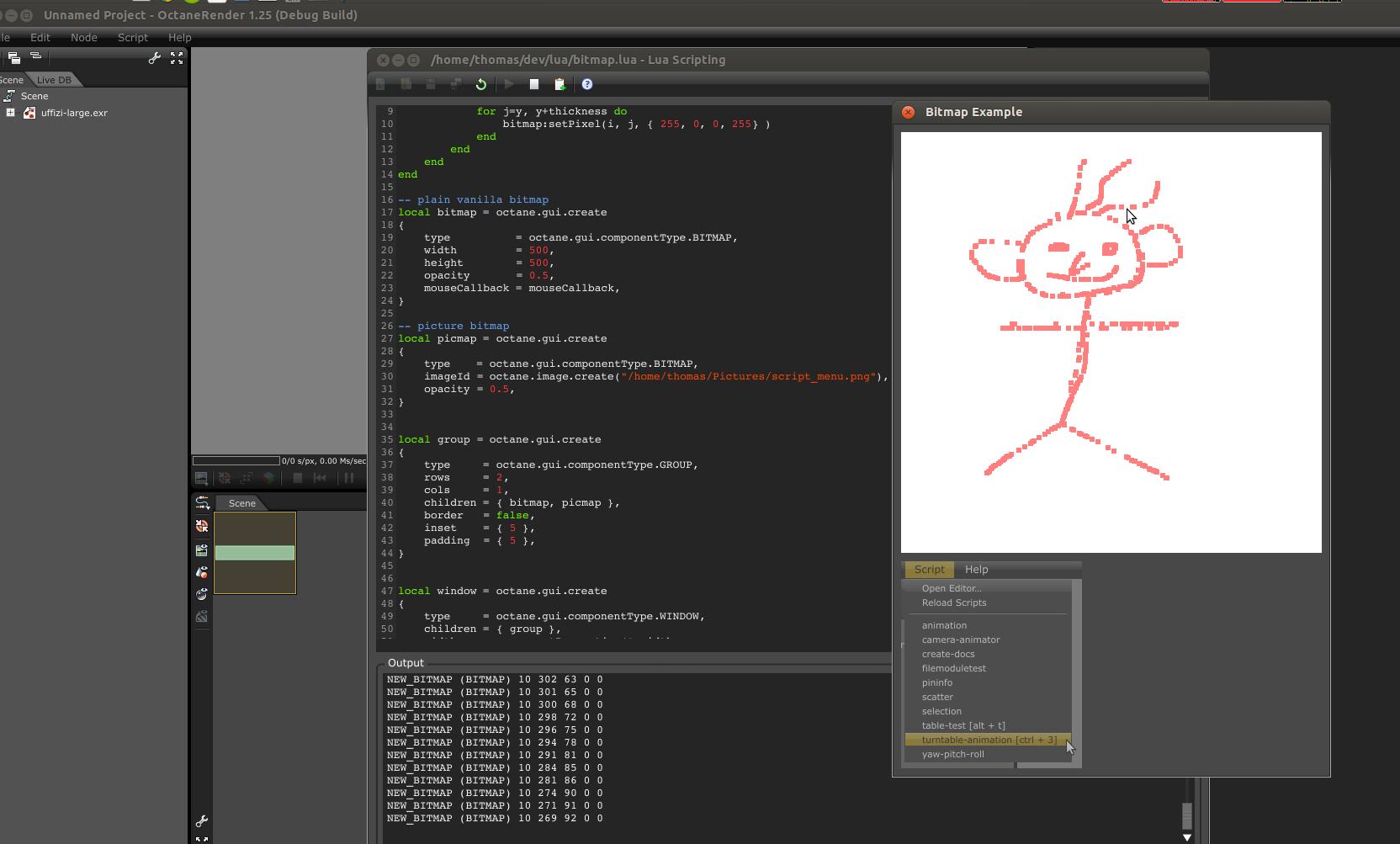

This is a simple example on how to use bitmaps in Lua (for something more complex see the live texture painting example). It creates 2 bitmaps. The top bitmap is used for free-drawing by hooking up a mouse listener. On a mouse down event we colour the pixel. The bottom bitmap just loads a picture with an opacity of 0.5. When a bitmap loads a picture, it's always resized to fit the picture. Keep this in mind when you're creating sprites for your script.
Here's the code:

-- draw something in the bitmap
for i=1,100 do
    for j=1,100 do
        bitmap:setPixel(i, j, { 0, 255, 0, 255 } )
    end
end
window:showWindow()
