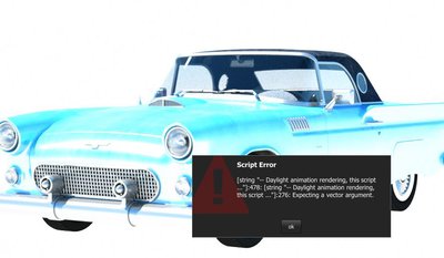

Thanks for sharing. Interesting I got this vector error issue.
Day Light script error
stratified
Posts: 945
Joined: Wed Aug 15, 2012 6:32 am
My mistake, setAnimator expects a list of vectors in 1.23, we relaxed this in 1.24.
I've update the initial post, it should work now.
cheers,
Thomas
Tugpsx
Posts: 1180
Location: Chicago, IL
Confirmed working now.
