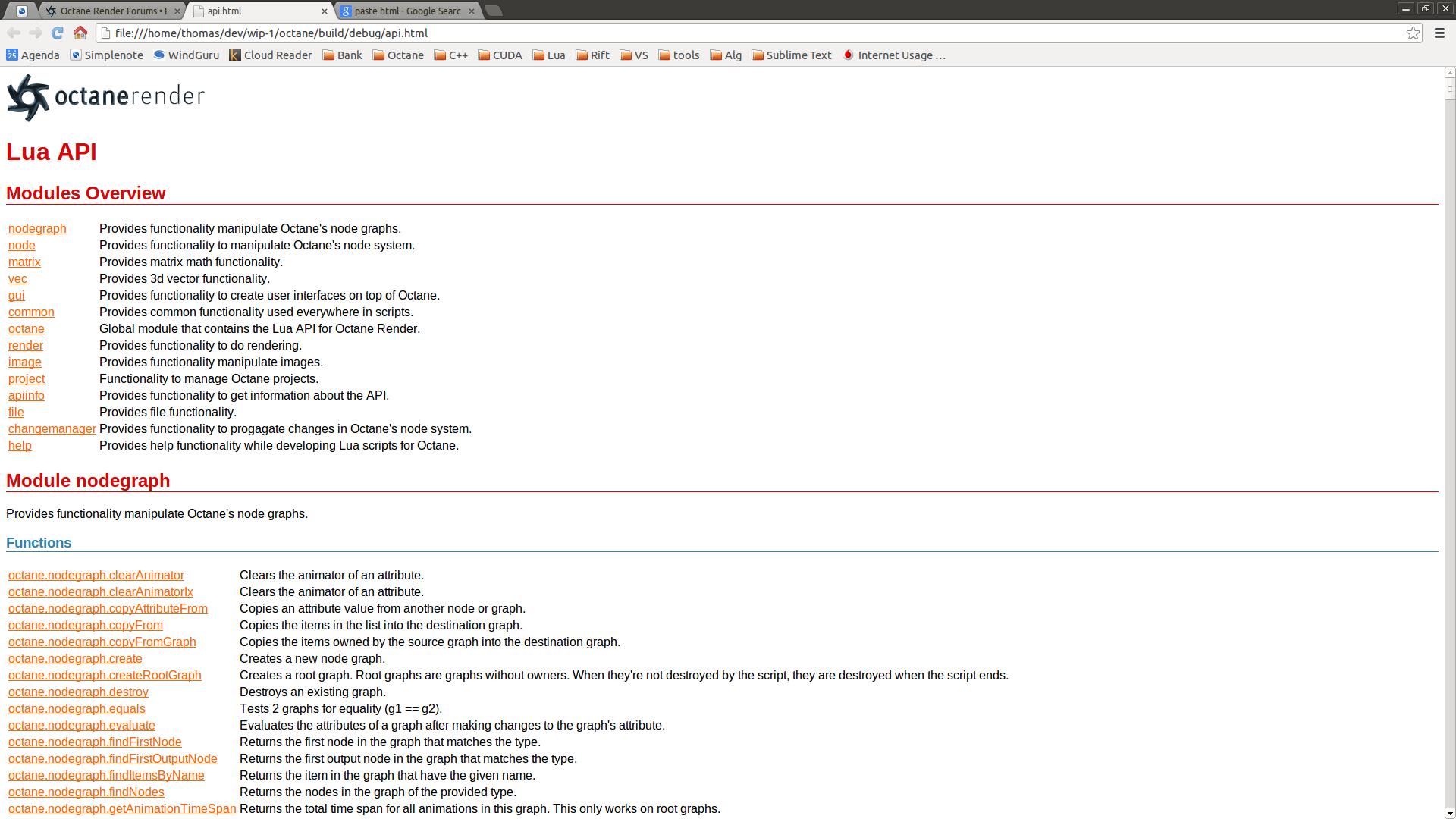

hi there,
For the people who don't like the API browser. I wrote a Lua script a while ago to create a html file describing the Octane Lua API. The script will ask for an output file.
create-docs.lua
html documentation creation script
(11.72 KiB) Downloaded 766 times
create-docs_213.lua
html documentation creation script for Standalone v2.13+
(11.7 KiB) Downloaded 1121 times
cheers,
Thomas

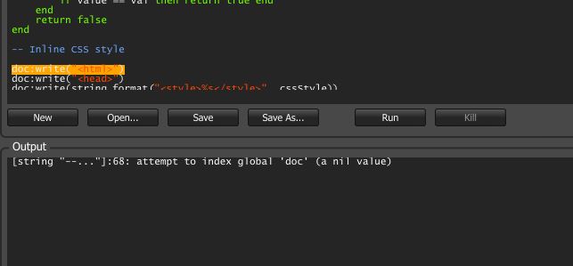

Output error with script
Lua doc error
Lua doc error
Also text in the Output area of the editor doesn't copy to clipboard

Hi there,
I modified the script to dump out an error when doc is nil. This can happend when that file is not writable. Could you try to use a different path in the variable HTML_FILE?
thanks,
Thomas

cheers,
Thomas
Code: Select all
-- Creates a single html that describes the Lua API. Run this thing from
-- within Octane. It creates a file api.html next to the Octane binary.
-- show the user a file chooser
result = octane.gui.showDialog
    type      = octane.gui.dialogType.FILE_DIALOG,
    title     = "Choose Lua API html doc output",
    wildcards = "*.html;*.htm",
    save      = true
-- try to open the file and show an error dialog if it failed
doc, errMsg = io.open(result.result, "w")
if not doc then
        type  = octane.gui.dialogType.ERROR_DIALOG,
        title = "File error",
        text  = errMsg
    -- stop the script
    error(errMsg)
end
