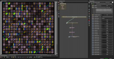

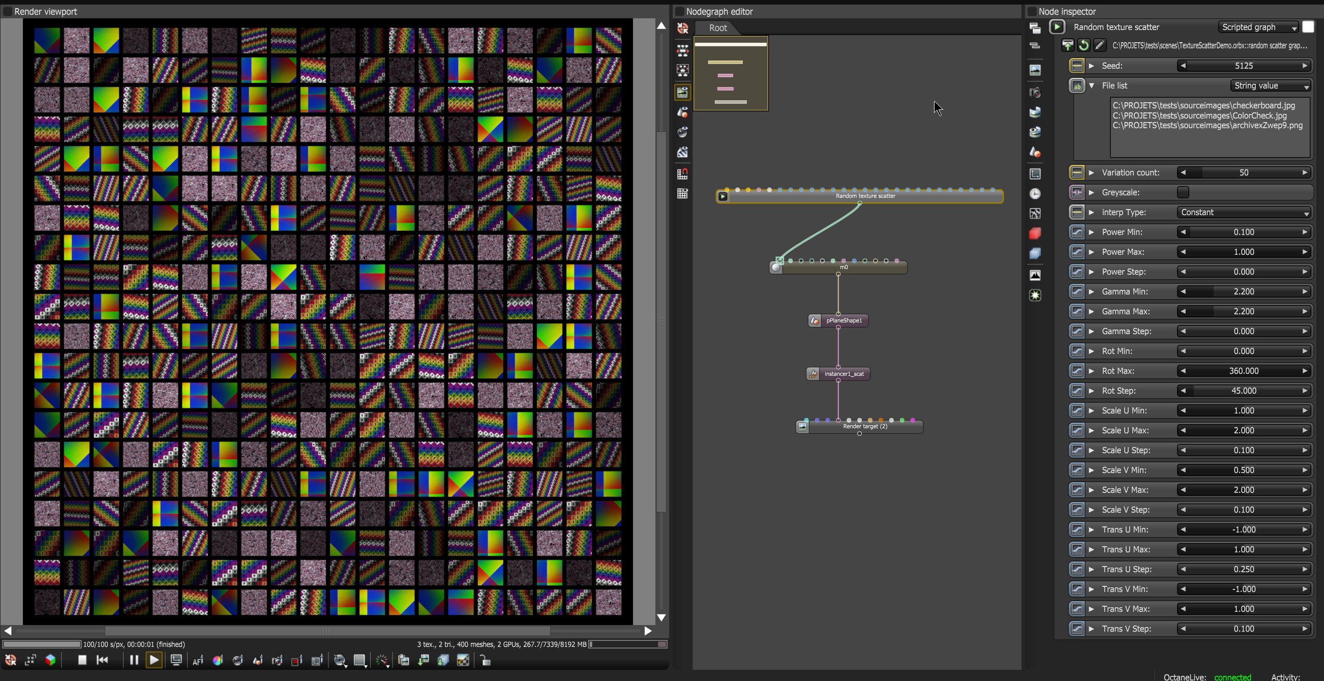

calus
Posts: 1308
Location: Paris
roeland wrote: Here's a starting point, but I haven't converted all the settings to input pins
Thank roeland :) ,
I have added the input pins (grossly).
Also, as changing one input was randomizing all other inputs,
I have changed Randomseed to be the input seed value.
Here is the new script graph:
random scatter graph.zip
(3.16 KiB) Downloaded 844 times
and here is a test scene with the script node inside:
TextureScatterDemo.orbx
(87.95 KiB) Downloaded 799 times
Change the File List to textures path on your disk, as they can't be included in the the ORBX ...

Calus,
This is really awesome what you did!!! Fantastic job! Thank you so so much.
Marcus - we've asked about but has anything changed - any chances to see world coordinates for displacement to apply it to the script? Imagine random textures with working displacement :ugeek:
