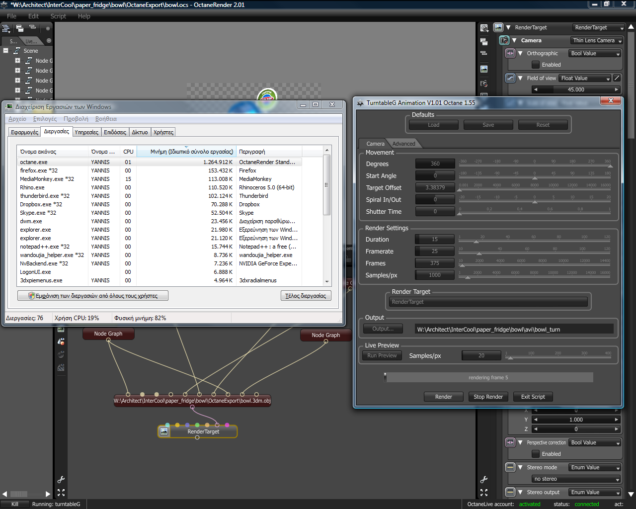

did you run a whole render turntable with 1920x1080 and 400 frames ?
i did that and at 275 memory use of octane.exe was 2 gb ( with not much intesive scene i will post today a screene shot with that...
And this memory spikes are always at the render loops ( mine and grimm's )
any thoughts ?
any thoughts ?
