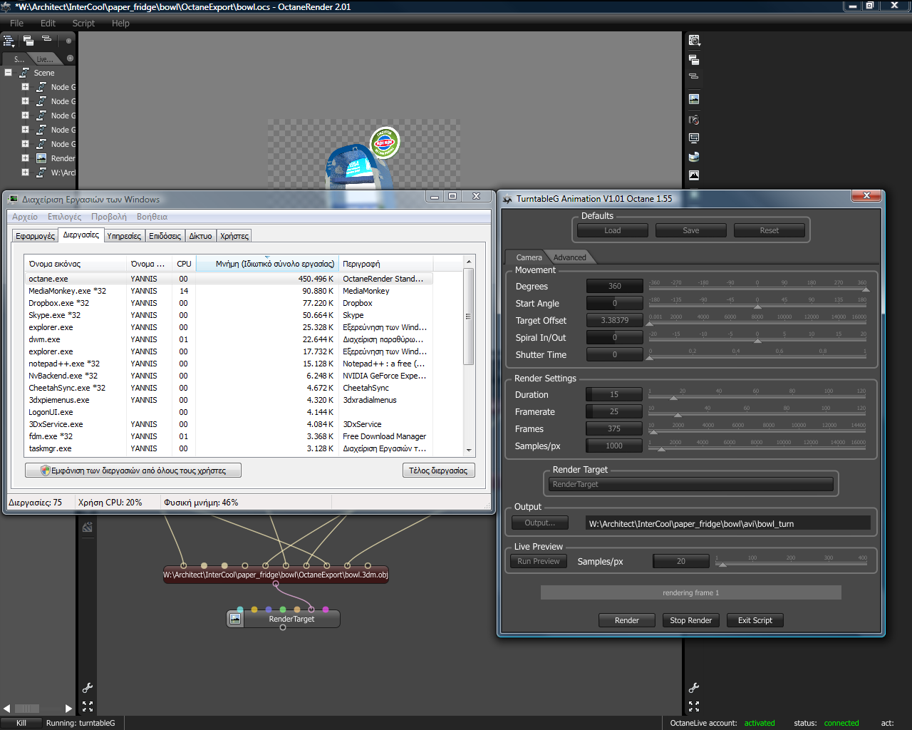

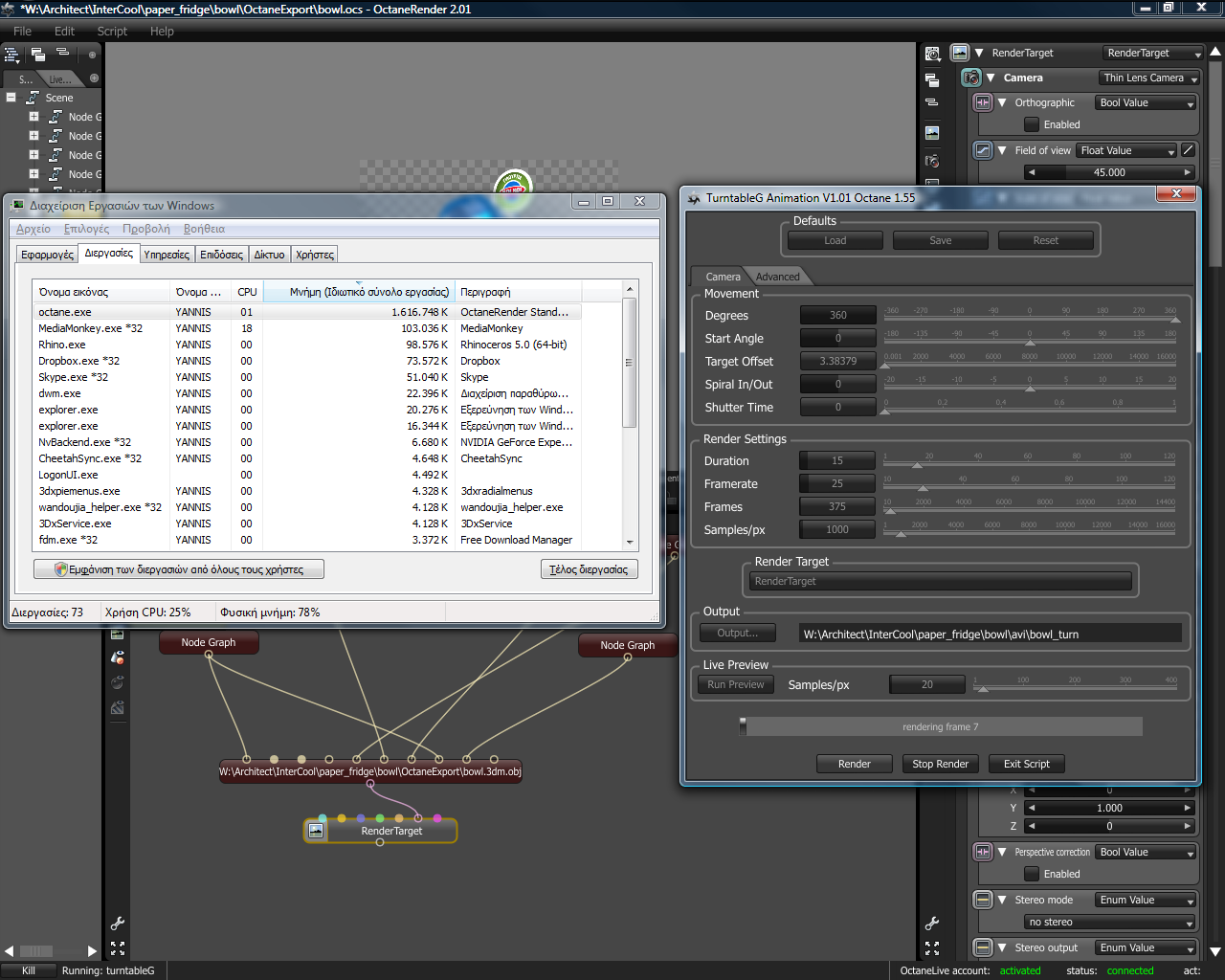

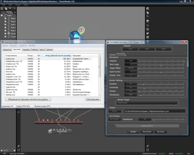

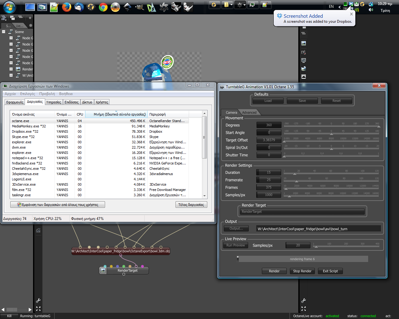

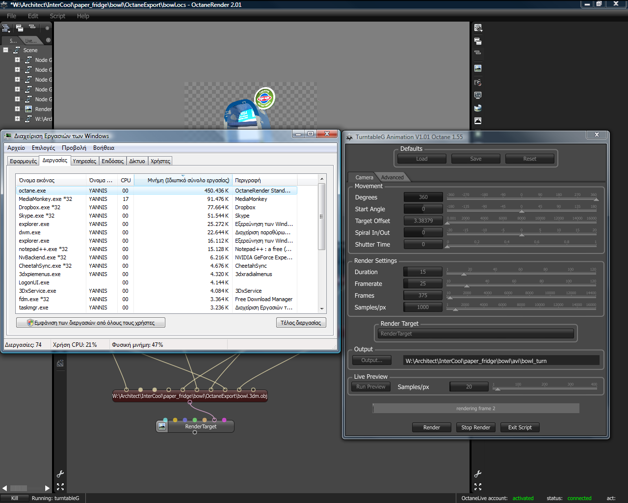

I dont know if i am doing something wrong but have a look ->
Here tou go : without collectgarbage() -- original grimm script
with collectgarbage()
gmillas
Posts: 45
Joined: Fri Jun 25, 2010 6:15 am
Location: Greece
And this memory spikes are always at the render loops ( mine and grimm's ) :?
any thoughts ?
