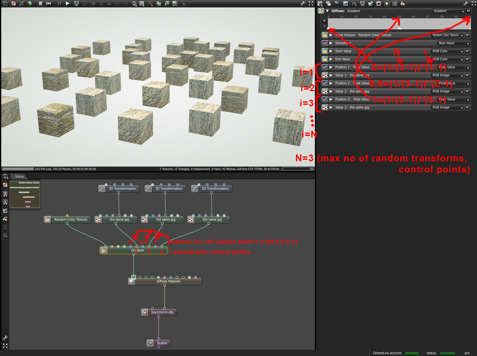

Namely: I can use "random color texture" and assign to gradient control points the same jpg texture and modify their input values independently - see the screenshot. This allows to transform the same texture over instances. The effect is - THEY DON'T LOOK THE SAME :) In my simple example (the screenshot) you see only 3 different transforms. But I can add more and more control points to the gradient node and get more and more different transforms of the same texture.
Let's assume I have 1000 instances. And I want to create 1000 control points in the gradient, connect the same image texture to them (as copies) and modify their transform independently and randomly.

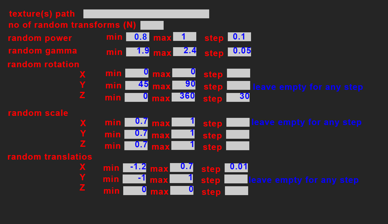

The input panel for random values may look like this - see the attachement.

Example of the input panel for random transforms
Node structure
Node structure

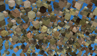

YES!!! :D :D :D :D :D :D :D :D :D :D :D :D IT WORKS. I am happy like a kid :)
At the screenshot you see one box, two textures and almost 2000 UVed instances - (almost, up to 256 variations) all look different.
So now it's time for more wishes :)
1. Could you please code extra option to select not only a folder for texture path but also a single image, or holding ctrl more images?
2. Could you please code extra option to lock U and V scaling together?
What is your opinion: is it possible to create just a node that would replace the script and it would have inputs same as inputs from the panel?
