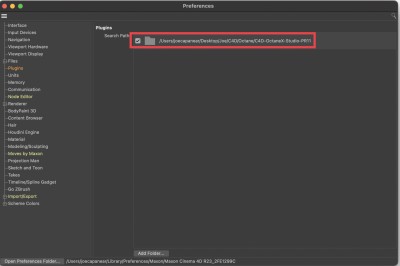

Please avoid to add the c4doctaneX plugin in c4d menu Edit/Preferences/Plugins, or it will give you conflicts:
