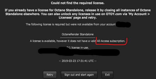

michax
Posts: 14
Joined: Mon Jun 07, 2010 3:17 am
Is this experimental release available for normal standalone license owners?
When trying to use it I'm getting error that i need All Access license (I currently own standalone octane 4 license).
Timmaigh!
Posts: 117
Joined: Thu Oct 21, 2010 9:10 am
Same question, do i need the new Enterprise license to try this out? 2019.1 XB1 works even without it...its kind of confusing at the moment.

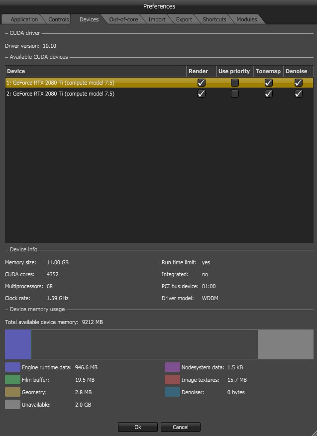

shine71
Posts: 137
Joined: Sat Mar 15, 2014 5:16 pm
"Q: How do I know my GPU is using hardware for ray tracing acceleration?
A: Make sure RTX acceleration is enabled in File > Preferences > Devices Tab > Use RTX acceleration (experimental). RTX acceleration will be enabled automatically for all devices which support RTX hardware acceleration, currently the NVidia Turing GPU range. "
Hi guys!
downlaoded and installed to play a bit with new features.
is it normal that I don't find any RTX control in this release, differently to what mentioned in main topic?
I attach a screenshot.
Thanks!
I7 5930k - 32 Gb ram - 2 x RTX 2080ti
http://www.marcodattilo.com
mojave
Posts: 1381
Joined: Sun Feb 08, 2015 10:35 pm
shine71 wrote:"Q: How do I know my GPU is using hardware for ray tracing acceleration?
Hi guys!
Thanks!
You must be using a different version as otherwise you'd see something different there. Please make sure you download one of the links from the initial post from this thread which are the only ones that currently support this feature.
