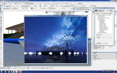

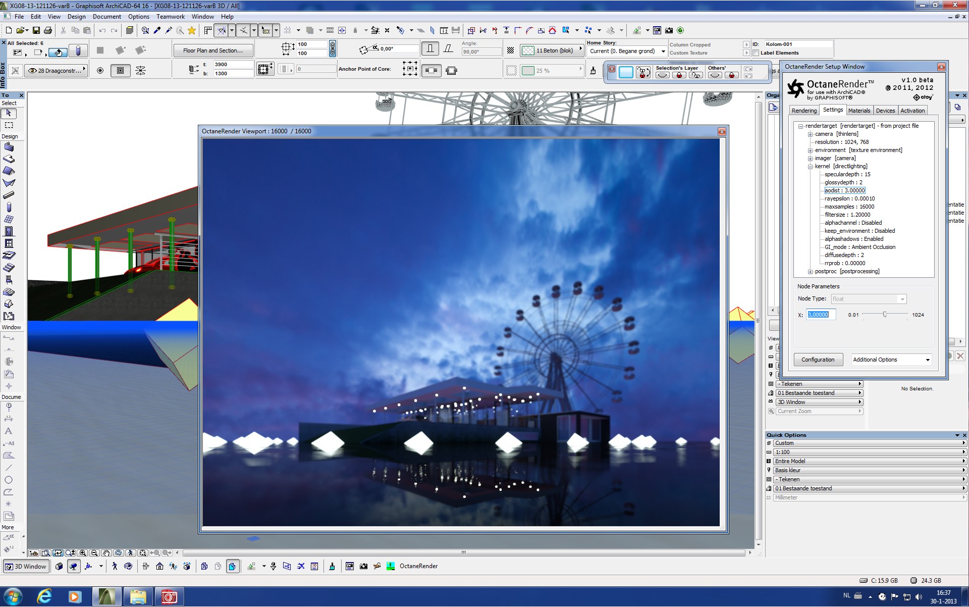

The closed beta test of the ArchiCAD plug-in has produced some fantastic renders so far, such as these created by rappet:
