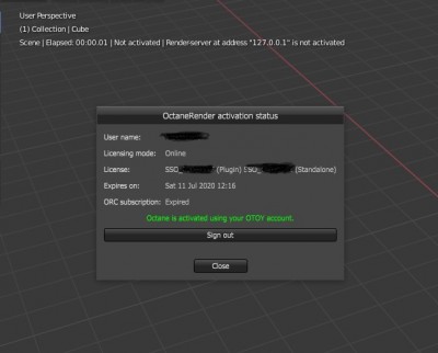

Is there a problem with the new free tier licensing??
Everything is activated and still can't use Octane in Blender.
I sent a note to support but thought I'd reach out to see if anyone else was experiencing the same issue(s)
What I sent to support: I just downloaded and installed both the new Octane Blender Free tier plugin and had to use a couple of unlocks to figure out what is going on with the licensing and getting it to work.
Still at a loss as everything seems to be activated but as you can see, it's not connecting to the server.
Can someone explain what I have to do to get it to work and reset all my unlocks?
