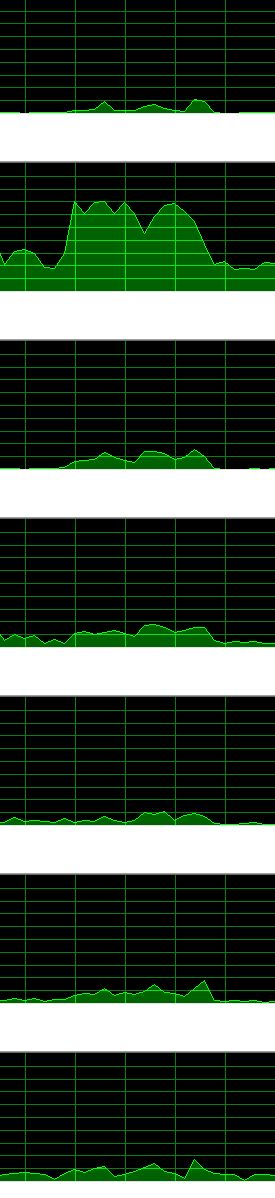

When the plugin is Loading Scene into Octane it can take a while when having to Process 10K elements.
Only the CPU is the bottleneck on this right?
I have been monitoring the CPU workload while processing and I noticed that multi threads are used, but not to the full.
What can I do (now on current PC or in future PC) to reduce this waiting?
Is this a general thing of the Standalone or is it also something you might be able to optimize in the plugin?

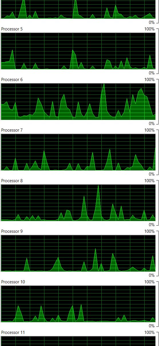

I also monitored the CPU core behaviour while generating heavy floorplans.
I have noticed that one core has high workload, and other cores have a small workload.
This might indicate that having many more cores the gain is relatively small coz' the extra cores will add some small amounts.
this examples in numbers (adding % workload);
my current i7 cpu 12 threads): 1x 70%+11x10%=180%
dual Xeon (40 threads); 1x 70%+39x10%=480%.
That would indicate that a dual Xeon could be 2,5 faster for generating (heavy) floorplans?
Do you think this assumption is correct?

Hi Jeroen - the plugin will extract all the geometry from ArchiCAD in a single thread, load that info into Octane in a single thread, but then Voxelize the data using multiple threads.
