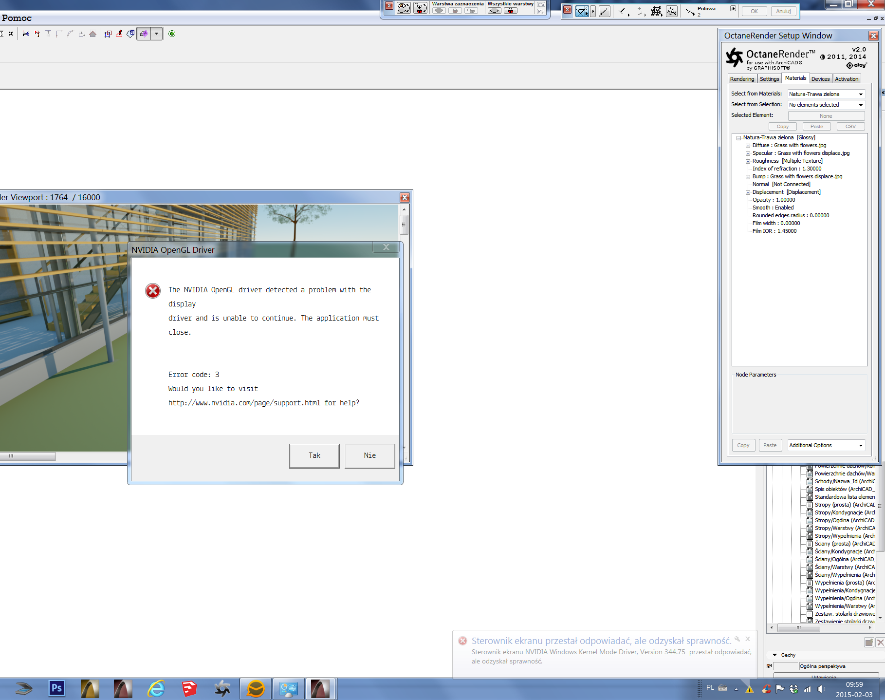

I've happened to notice one thing.
Tried to assign a grass material from DB, called Grass with flowers to my AC texture and experienced a black screen and then NVIDIA Open GL Driver error window as attached.
Archicad was closed but didn't generate a bug window as usual only a RPT file, not able to attach here.
Other DB materials work OK, so I didn't bother to search Nvidia site for that issue.
The message below says that "Driver stopped responding and has recovered".
Marek

Hi Marek. That material has displacement - which I suspect if causing your video drivers to timeout (see question 4 at http://render.otoy.com/manuals/ArchiCAD/?page_id=274), since that LiveDb material worked OK for me. If you install Octane Standalone 2.16 from http://render.otoy.com/forum/viewtopic.php?f=24&t=44074 it should make the appropriate registry setting changes to fix this.

Hi Paul,
I've got already Octane Standalone Edition version 2.20 installed.
Should I downgrade it to v.2.16?
Marek
face_off
Posts: 15829
Location: Adelaide, Australia
You need to run any Octane Standalone installer. It's the installer which updates the registry settings. If you installed from the ZIP archive that doesn't happen - you need to run the installer EXE.
Paul
marek
Posts: 44
Joined: Tue Nov 11, 2014 2:57 pm
My installation file: OctaneRender_2_20_win64.exe.
Marek
face_off
Posts: 15829
OK. You'll need to do some experimenting then if you want to use that Liveb material. Try applying to an empty scene with a single slab and opening the Viewport. You could also try setting the displacement amount to 0.00001 and open the Viewport. Your graphics card and other hardware is superior to mine, so you should be able to use that material. If all else fails, set the displacement to 0, open the Viewport, save to ORBX and send me that file (indicating the material name with the grass displacement material applied).
