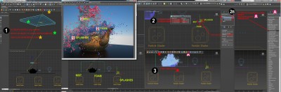

Attached a screenshot with a how-to for Octane 3dsMax and Phoenix FD particles
Regards

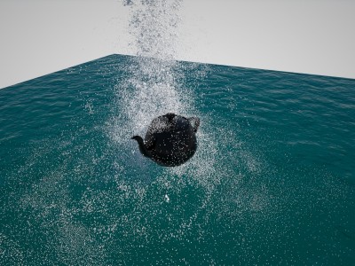

So foam in vray is millions of round sphere meshes? It looks almost like smoke since there are billions of splash particles.
If you look at this video foam and splash do not look like a bunch of little spheres. Are they proceduralyl generated? (basically during rendering vray replaces spheres with a nice fluffy foam texture) https://youtu.be/Oujp1pFa4hE
Not sure if octane can handle millions of physical mesh spheres to create foam like in this video.

Hi coilbook,
It depends on the settings, I only have a demo version, there's a limit about density.

Please disregard my post in 3ds max. I got foam to work by using group index

Hi xevious2501,
Octane supports Particles, splash, foam and volume; developers will fix PhoenixFD RGB chanel soon.
viewtopic.php?f=27&t=68430&p=343781&hilit=+wsm#p343781

damn, still can't get phoenix fd working - does it work on 2018.1 beta 4 - can you do some tut demo / .max file to test out a working one? Just want to do simple smoke or water.. using the tire burnout demo from phoenix fd
EDIT: Sweet finally works, just popped the Octanevolume wsm on top of the smoke sim, added colume medium, raised the scatter to white and it's there - from the new 2018.1 7.04
