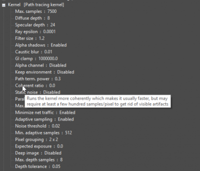

are there any recommendations I should tweak in Octane to get the maximum speed for my renders? (Increasing bucket size, etc? )
core 8700K, 32RAM, GTX1080TI

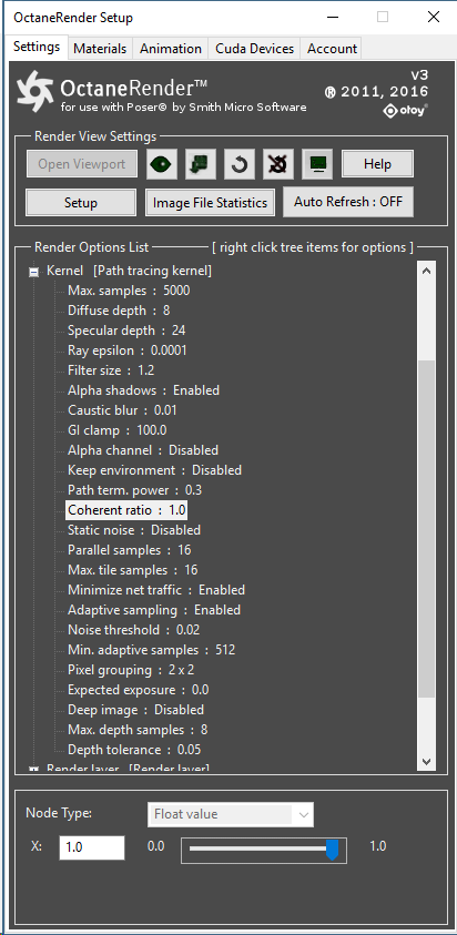

I used these settings:

wimvdb wrote:I used these settings:
thanks yet again, Wimvdb! :)
The attachment renderfast.png is no longer available

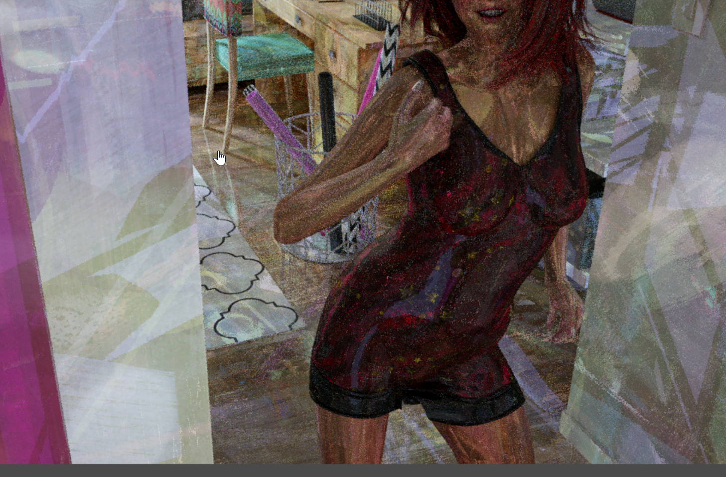

strange. I rendered after changing the settings to match yours, and I get this cartoonish-like result:
any idea why?
*update*
changing the coherent ratio to 1.0 caused this. when I put it back to the default it renders normally. but its cool to know I can create toon-like rendering with this tweak :O.

Coherent mode needs at least 500 samples (it starts very noisy).
You could also try to increase the max tile size to 32. That may render faster as well.
