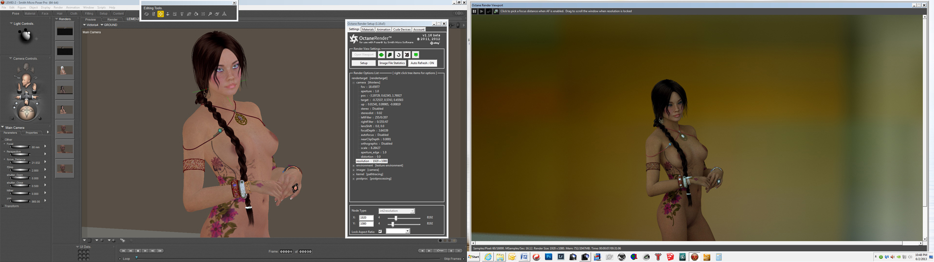

I cant match my poser view with my octane view what am I doing wrong??

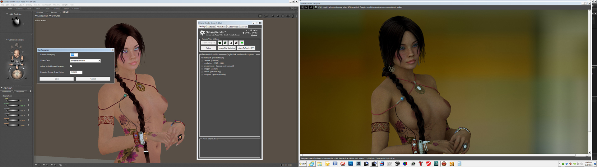

ok thanks Paul ,
I attached the screen shot (please forgive nudity)
that solved the problem? (allow scaled poser camera)
but I don't understand why octane is 2.62128??
what does that number represent?
is this the default we must keep?
No - I thought that might have caused the problem. It allows you to scale the Poser camera, which puts the field of view out of sync with the Octane Viewport.
That's the stand conversion of Poser units (that the Poser geometry is stored in ) to metric metres.
There shouldn't be any need to change this number.
From the screenshot, it looks like the issue is fixed now?

thanks Paul
no clue what happened (maybe 1.6 bug?)
so checking that allow scale fixed it.
