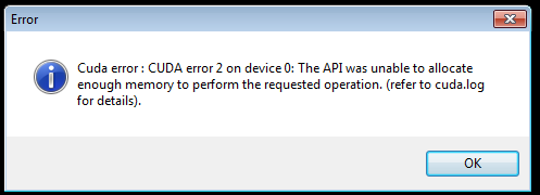

A quick note to say the next version has some substantially improved error reporting. If there are any Octane or Cuda errors, these are picked up by the plugin, displayed to the user, and then the plugin gracefully closes, and a "cuda.log" file is written detailing the issue. This will hopefully pickup any mesh construction issues or out of memory errors before they manifest into a python exception or Poser crash. The viewport also has a low memory warning (if you go below 20Mb of video card memory free).
