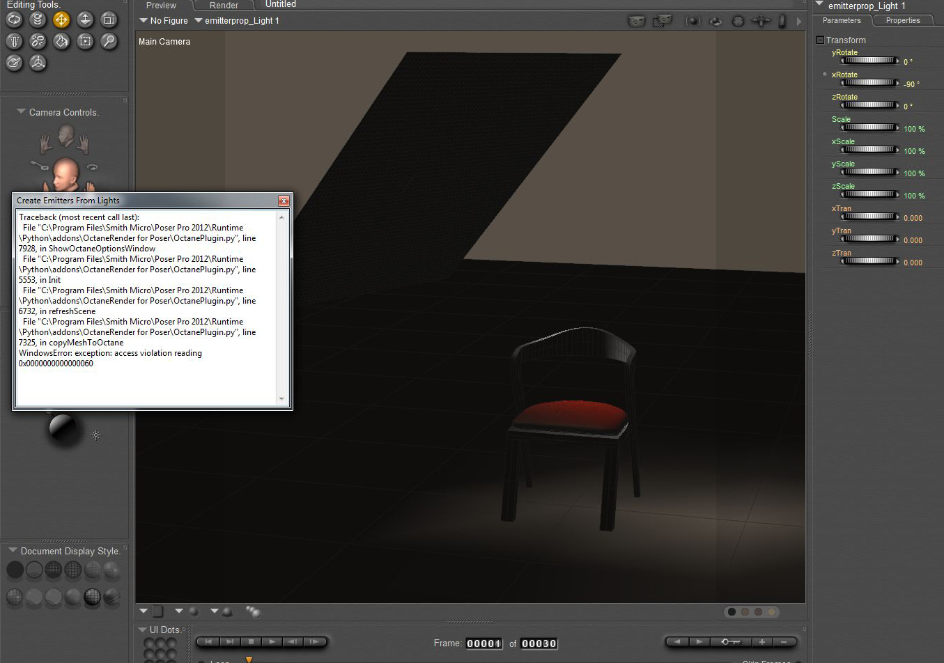

I receive an error when attempting to launch the plugin when certain objects are included in a scene. I've successfully launched the plugin with a primitive loaded into the scene.
- Operating System: Win7
- 64 bit
- Amount of RAM: 16Gb
- Graphics Card: GT440/GTX 560
- Nvidia driver version: 306.97
- Poser version: 9.0.3.23027
Win 8.1 x64 | i7-6700 | ASRock Z170 OC Formula | GTX 980 TI 6GB | GTX 980 4GB | 32Gb RAM
Galatea - would it be possible to email the prop to me at [email protected], and I'll find out what is causing the issue.
Paul
