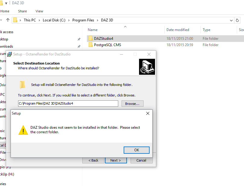

I have just tried to install and get this message.
I am now using Windows 10 64bit and DAZ is definitely installed in the right folder.
I am using DAZ 4.8.0.59.
Windows 10 64bit, i7-3770 @ 3.4Gh, 32Gb RAM, GTX-780 3GB
sixb0nes
Posts: 42
Joined: Sun Nov 17, 2013 8:19 pm
Location: Canada
spider58 wrote:I have just tried to install and get this message.
I can confirm the same issue as above. Windows 7 64bit. Daz 4.8.0.59 as well.
My apologies - there was an issue with the installer. Can you pls re-download from the link above and try again.
Paul
sixb0nes
Posts: 42
Location: Canada
That did the trick. Installed, confirmed version 2.24.2.1. Test render success.

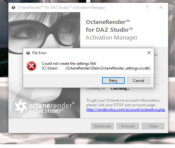

I tried to install both OctaneRender standalone and OctaneRender_for_DazStudio_2_24_2_1_Win64 on a new workstation on which Octane was not yet installed.
Standalone install and activation run without issues.
Installation of OctaneRender_for_DazStudio_2_24_2_1_Win64 in Daz Studio Pro BETA - version 4.9.0.36 got stuck at the activation process.
Error:
Could not create the settings file!
C:Users/USERNAME/OctaneRender/Data/OctaneRender_settings.oczdb
Update/Edit:
removed workaround so the cause of the issue can be tracked down.
Update/Edit: 2:
This error seems only to be triggered when installing on a NEW workstation on which before OcDS was NOT installed.
If on your computer
- OcDS was allready installed with an older installer
- a OctaneRender_settings.oczdb file was created
- OcDS was activated
- registry entires were created
you will not be able to reproduce the error.
Try running OctaneACM (from C:\Users\Paul\Documents\OctanePluginInstallerBuilds\DazStudio) as Administrator.
Paul

Update/Edit:
- removed a workaround I found that solved the issue temporarily but will prevent tracking down the root cause.
I will try again on the laptop to see if I can replicate the issue and solve it by running OctaneACM
from C:\Program Files\DAZ 3D\DAZStudio4".
