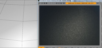

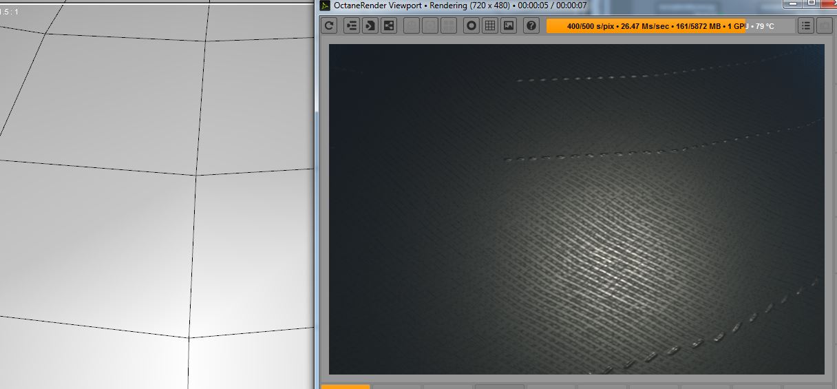

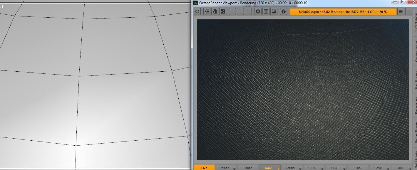

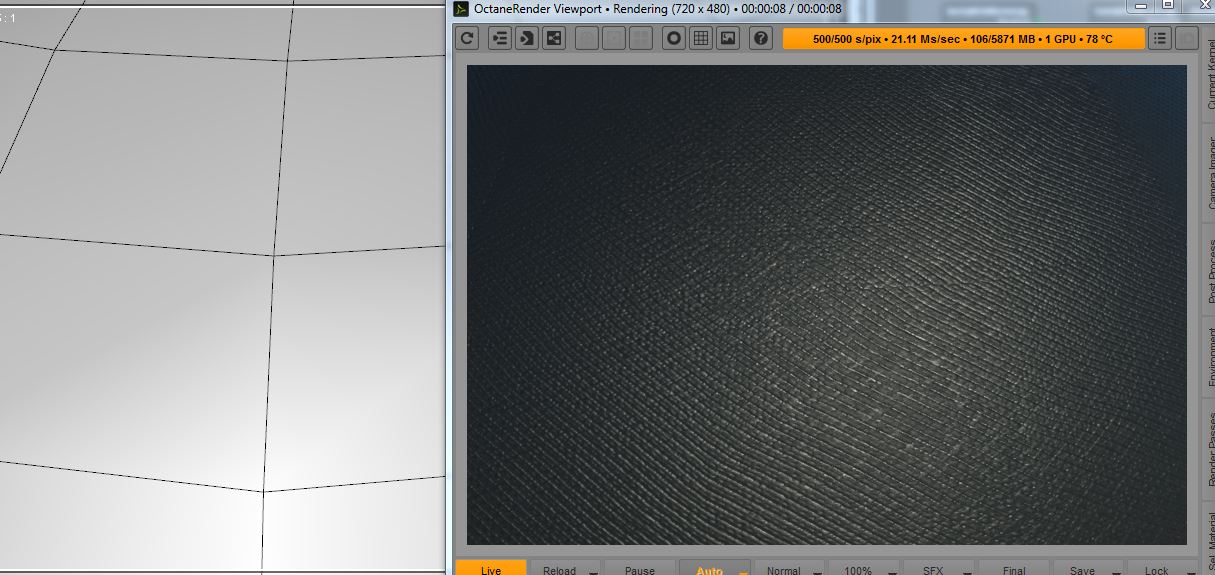

I came across another problem: when I plug both displacement and bump maps into the material, the different polygons of the mesh look different. The bump alone doesn't have it, and the displacement alone doesn't have it.
I attached 3 images: one with only bump, one with only displacement and one with both that show the problem. How do I fix that?

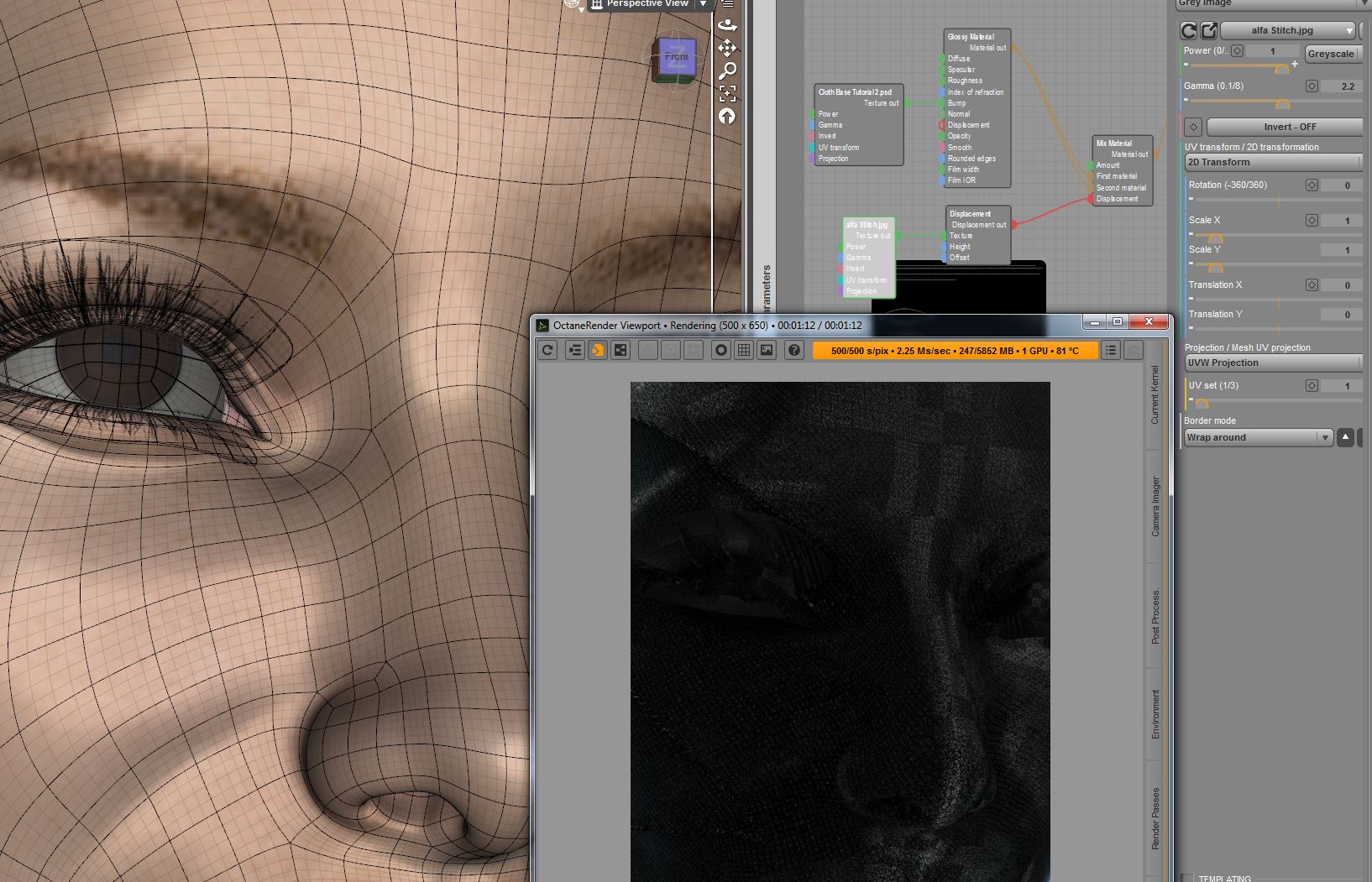

Here is a screen cap, some of the polygons look flipped
Sorel
Posts: 264
Joined: Tue Feb 25, 2014 5:22 pm
Elele wrote:Here is a screen cap, some of the polygons look flipped
I've seen this sometimes on some items that have displacement. Make sure the level of detail is set accordingly in the drop down (it goes from 1042 up to 8096 or something like that). This usually fixes the problem for me, or sometimes I need to mess with the height and offset a bit.
