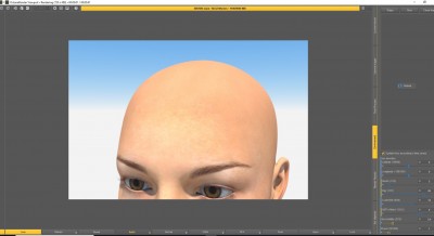

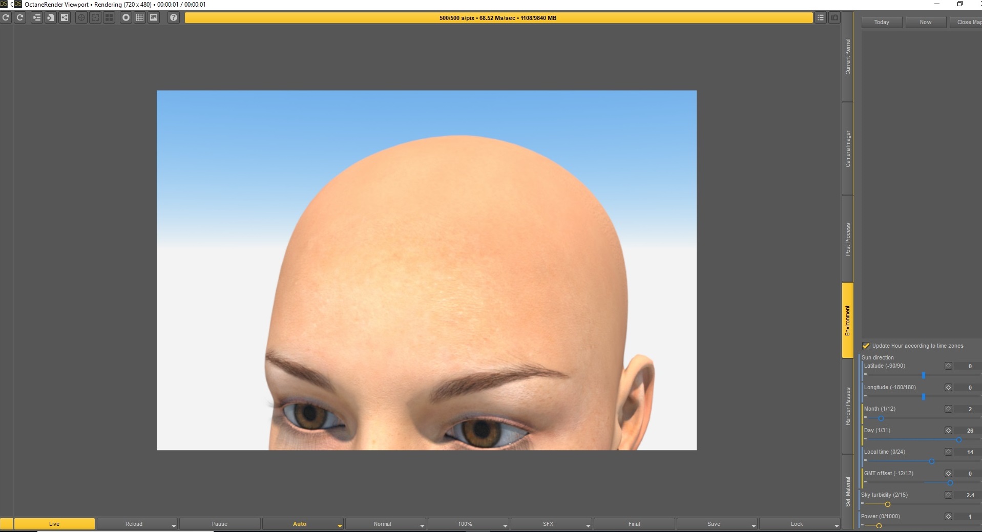

Hi Paul,
Have a bug to report. Not sure if the behavior is correct or not. If I have a scene with a custom environment under Octane -> Environments tab (e.g. I have set a new name for the environment and it has additional sky texture) and I set this scene file as the default scene to load in Daz Studio (Edit->Preference and under Startup check the Load File and select this scene file to load). Then when I close Daz Studio and re start it, I see the scene that I saved as the default scene file that loads but under the Octane->Environment tab the custom settings that I saved with the scene are not there. It either shows No Environment or loads one of the default environments even though the scene file was saved with a custom environment name and settings.
Steps to reproduce :
1. Open Daz Sudio.
2. Create a New scene in Daz Studio.
3. Change settings in Octane->Environment Tab and give it a custom name. In my case I had imported one of my saved environment settings so it had that name. You can also change settings in the Render Settings Tab if you want to. I have done this as I use a custom render setting for all my renders.
4. Save the file with a known name. E.g. Default Scene.duf
5. Open Daz preferences (Edit->Preferences)
6. Under Startup check the Load File and browse to the scene file that saw saved in step 4.
7. Close Daz Studio.
8. Open Daz Studio, you should see the default scene file loaded (name appearing in the title bar).
9. Go to the Octane- >Environment Tab. You will see instead of the custom settings that you had saved the file with, it now has been replaced by either No Environment or some other default environment. (The Render Settings should be as per what was set).
My aim is to basically set a default scene file with all the customized Octane settings that I use so that I don't need to set all the settings every time I start a new scene. I hope you can fix this in the next release.
Btw. if I use File->Open to open the file saved in step 4, then the Octane->Environment Tab has the correct custom settings. So the wrong settings is only there if the file gets open as a default scene file. Maybe something in the Octane plugin initialization code is overwriting the environment settings. Probably a check is needed to see if the scene already has an environment setting and if so, use that instead of adding the default environment settings.
Regards,
Rajib
PS : My system configuration and Daz / Octane version I am using are in my signature.
