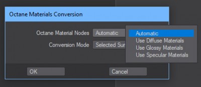

Carlos3D
Posts: 116
Joined: Thu Feb 26, 2015 5:45 pm
Hi juanjgon .
I am an Octane user that I use a lot in my works, the option material convert.
So I would ask the special combos that juanjgon would make an update and improvements to this special function.
Convert also to Metalic and universal materials.
Thankful.
