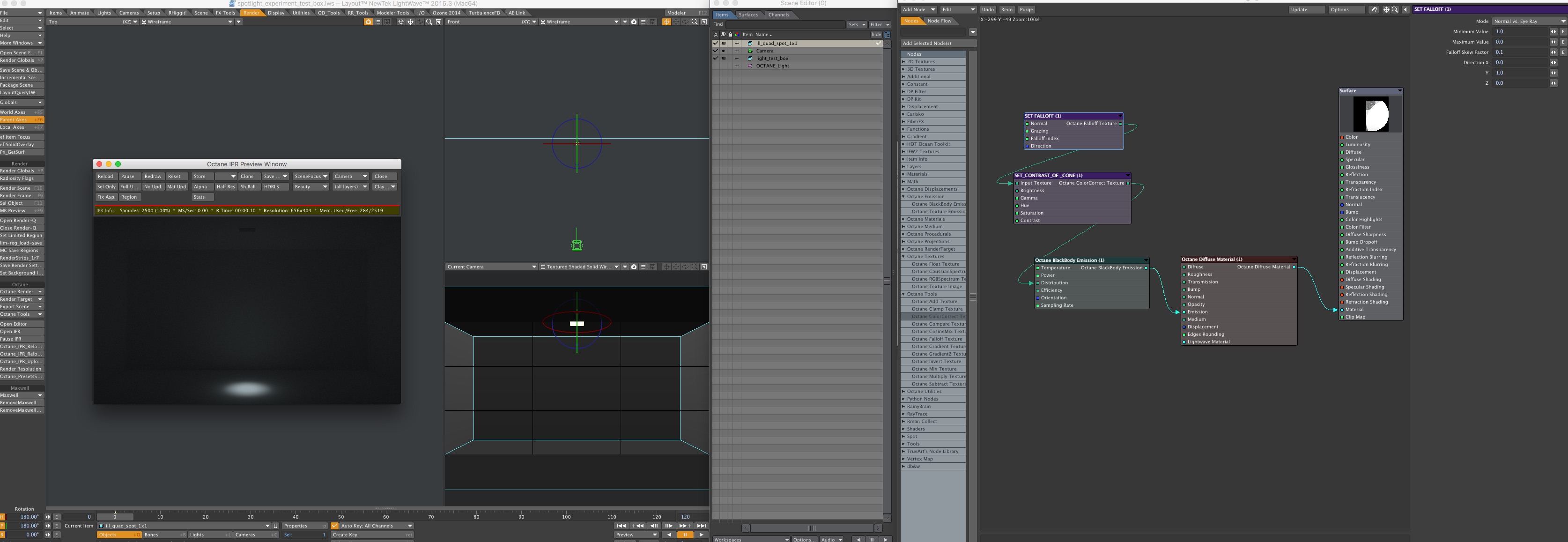

have a look at this ;-)
octane_falloff_emitter.zip
(17.45 KiB) Downloaded 314 times

Thanks! This shader setup could be integrated as an option in the Octane_light objects. What parameters should be exposed from the nodes in the Octane_light GUI to control it?

i need to experiment more with it, but i seems that 'falloff skew factor' in the falloff node and 'contrast' in the colorcorrect node are the most useful ones . the light color could be used from LW light dialog, to maintain coherence with other octane lights.
