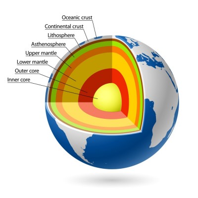

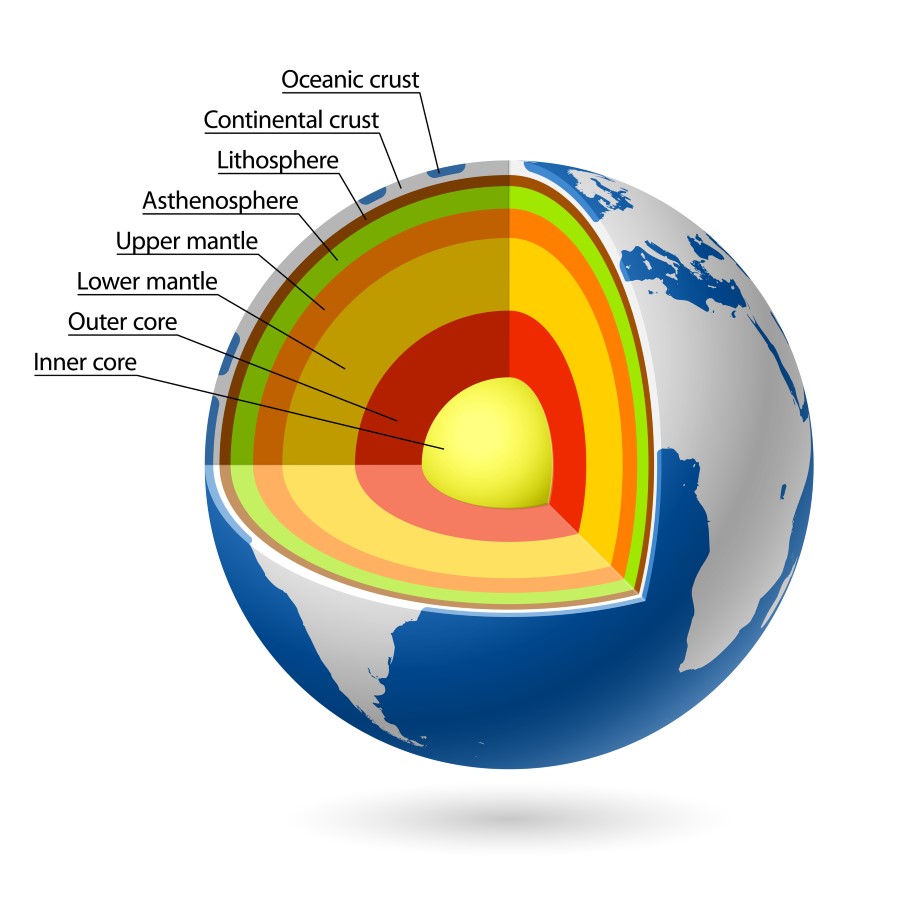

Anyone have any idea how to create a 3D gradient in octane, I'm stumped!
See attached for a reference, the colour in the centre of the sphere needs to 1 colour and the outer 'mantle' needs to be another.
Thanks!

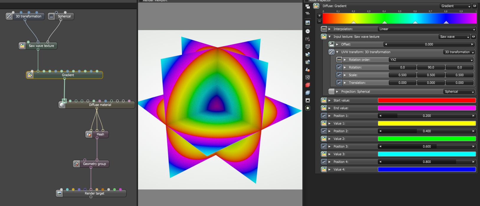

Godstrike wrote:Anyone have any idea how to create a 3D gradient in octane, I'm stumped!
I don't know the Lightwave plugin but you should have the same nodes as in standalone.
Here is how to do it in standalone :
sphericalRamp.orbx
(86.02 KiB) Downloaded 204 times

Godstrike
Posts: 128
Joined: Sat Apr 16, 2011 9:10 pm
Many thanks! Will have to get to grips with the standalone for this shot:)
