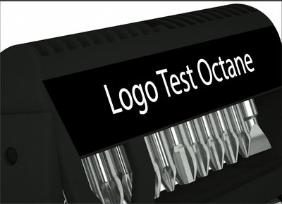

i want to assign a logo to a model. The logo is a png file with transparency. When i put that into the diffuse channel of my material node the logo area seems to be filled with a black background. In lightwave i often use multiply or add to get a logo or any transparent texture on a model. How can i achieve this in octane? Thanks for any help.

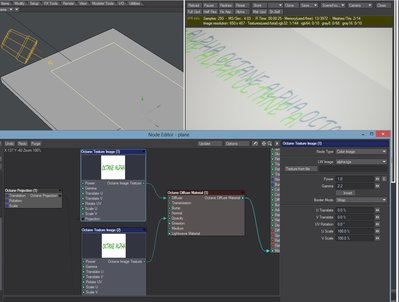

Double-click the Texture Image node you have your image in. Then change to Alpha Image in Node Type.

It is already set to alpha image. Does octane need a specific file type?
Edit: The main material is plastic (diffuse mat. with turbulence). I only want to add a logo on top of it like with lightwave blending modes.

32bit PNG should work... do you have Alpha Enabled in the LW Image Editor dialog?
Trying to remember how I overlay something without having LW open... I think I use 2 materials and use Material Mixer.. and a 24bit b/w image (opacity map) for the one I want to overlay - and plug into amount... ya, that's da ticket.

Thank you both. I'll try that later. For now i have to stick to lw renderer to get the project done.

Thanks FrankPooleFloating. Works fine!FrankPooleFloating wrote:I think I use 2 materials and use Material Mixer.. and a 24bit b/w image (opacity map) for the one I want to overlay - and plug into amount... ya, that's da ticket.
